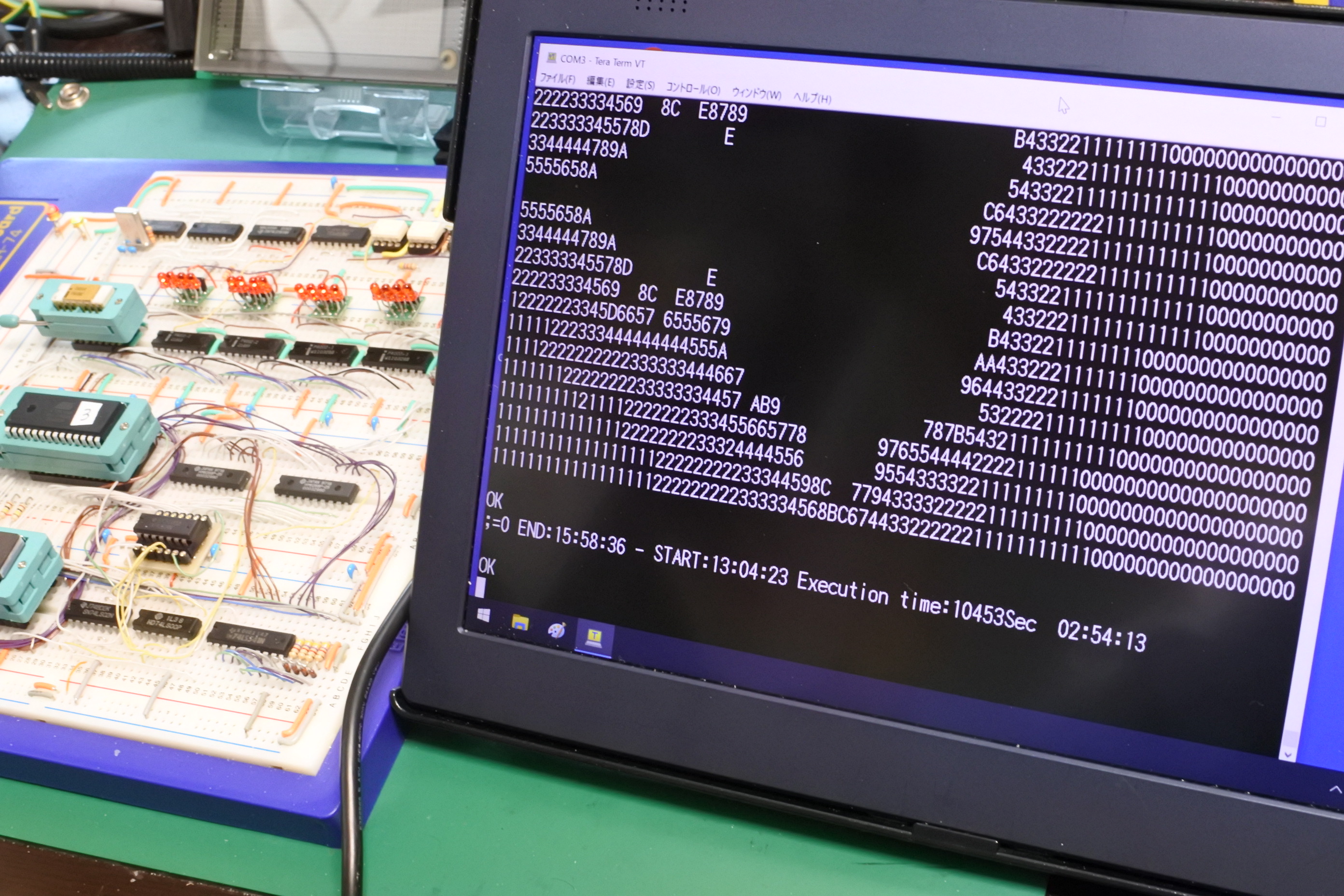

I'm all on board with idea of a minimal basic for a tiny system, and trying to do an integer-based mandelbrot on it. VTL02 is certainly worth a look, if you haven't looked yet. It's wonderful and terrifying.
I was wandering the web and came across this:
5 ) MANDELBROT.VTL
10 F=50
20 Y=-12
30 X=-39
40 C=X*229/100
50 D=Y*416/100
60 A=C
70 B=D
80 I=0
90 Q=B/F S=B-(Q*F)
100 T=((A*A)-(B*B))/F+C
110 B=2*((A*Q)+(A*S/F))+D
120 A=T
130 P=A/F Q=B/F
140 ;=((P*P)+(Q*Q))>5 #=180
150 I=I+1 ;=I<16 #=90
160 ?=" ";
170 #=200
180 ;=I>10 I=I+7
190 $=48+I
200 ;=X<39 X=X+1 #=40
210 ?=""
220 ;=Y<12 Y=Y+1 #=30
Looks like the 4004 rendered it in a touch under 3 hours:
My joy was premature, because it's immediately clear that this is a non-standard impementation, with multiple statements per line (easy fix) and signed 16-bit integers (a bit more difficult). If I have some time I'll play around with it next weekend. I'm optimistic that I'll demolish the 4004's time, even with a soft-kludge for negative integers. A Woz BASIC version should definitely come first, but I'll have to go 80-columns with a PR#3 and hope that the firmware plays nicely. Curiously, VTL-2 has a built-in version of PRINT CHR$(), but Woz BASIC doesn't.
A-Ha. Just the thing...
FWIW, a month or so back, I started with an IL Based TinyBasic on another CPU to port my Apricot programming language with, but ended up just porting/re-writing a TinyBasic - I'll do a longer post about it later on,,, Meanwhile I've been looking at my own Mandelbrot programs with a view to porting them using scaled integers, but this VTL program runs nicely when translated into my TB which supports 16 bit signed integers only.
>LIST
    5  !160=0

>RUN
111111111111112222222222222333334568BD67543322222211111111111110000000000000000

Time: 84 secs.
Without going into too many details here, it fails the 2KB test, being 3.6KB right now (and needs external getchar/putchar/getline functions) but is quite "full featured" with DO/UNTL and FOR/NEXT. Also some BBC/Acorn-isms, like byte and word indirection (? and ! commands- the !160=0 above sets the centisecond timer to zero and !160 reads it). also VDU does the same as PRINT CHR$(x); It also supports strings to a degree, but memory management is left as an exercise to the user. Hex numbers are per the Acorn standard &12AB and to print, prefix with a ~.
I'll post more (plus sources) in a few days when I get it all together with some more demos, etc. but this isn't and never will be a 2K Basic (nor is it particularly fast - it's between 1.5 and 2 times slower than EhBasic - that time of 84 seconds is on a 16Mhz 6502) It might just fit into a small system with 4K of ROM and 1K of RAM though (512 bytes for your program though - tight!). I can shave off 100-200 bytes if needed for e.g. serial IO so making it fit into a 4K ROM ought to be fine.
Ps. Think I'll stick to keeping VTL read-only for now ;-)

Nicely done! Your output doesn't quite match the reference image, because in VTL-2 < means less than and > is its logical complement, which is greater than or equal to :D
PostPosted: Thu Oct 05, 2023 6:05 am
Posts: 1488
Ah, I did wonder why it was slightly different but it was getting late last night... Fixed it to get...
