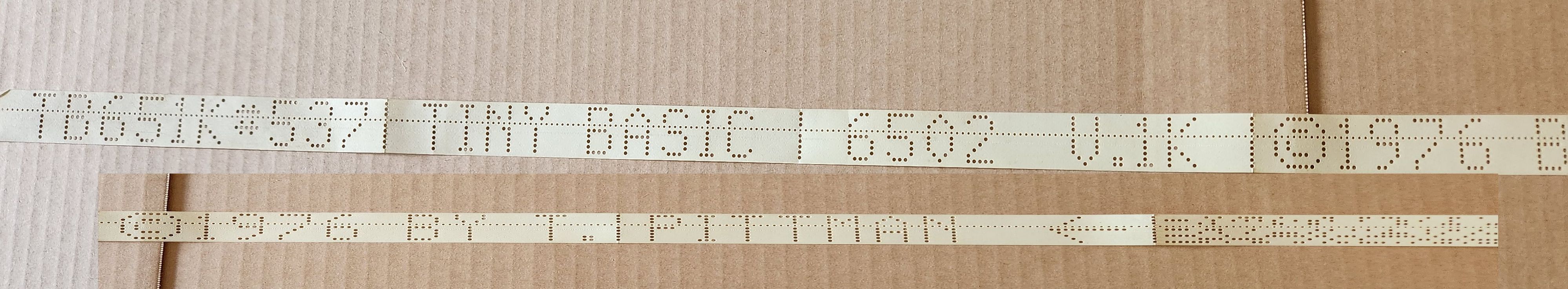

By request This is the leader to the fan fold tape!

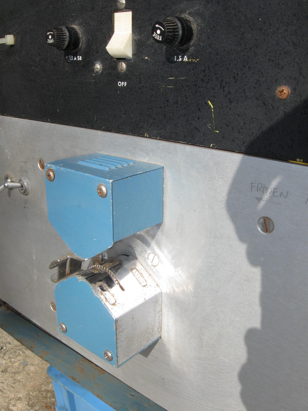

Here's a nostalgia photo from my own collection... some of the gear I rigged up back in my KIM-1 days!
And yes I had Tom Pittmans' Tiny Basic up and running. :) I ordered the tape by mail, probably in response to an ad in Byte magazine.
