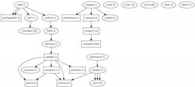

Attached an Excel workbook with a disassembly listing ("asm") built from tracing the execution of a couple of seconds of the Robotron intro. The emulator tracks the leaps from and to instructions, then runs an algorithm to structure the code logically. I've implemented a number of suggestions I got from above posts, thanks for the inspiration!
As a complement to "asm" I've added "map" (condensed picture of the memory of the code) and "ann" (annotations to addresses). For reference purposes I have added the complete listing on "raw" (generated by a static disassembler). Not included in the workbook are the Excel macros which drive the workbench, so it's just a snapshot.
Some explanations to make reading the listing on sheet "asm" easier:
  • The addresses shown are consecutive in memory. This leaves big swaths of .byte data. Some of the data can be identified as ascii. These are further screens of the intro which have not been touched in this particular run. I intend to approach those further parts of the code in a piecemeal fashion, always trying to identify some structures before moving on with discovering of new stretches of code.
  • Most of the labels are auto-generated (S for JSR entry points, L for branches, J for JMP targets).
  • There are some manual labels which are supplied to the emulator before it starts, e.g. chromatix01 (multiplication routine as pointed out by chromatix) or copyPagesAtoY (explained in White Flame's video).
  • Some special labels show access to Apple II softswitches and ROM routines.
  • The comments contain a lot of '>' and '<' info. That's the addresses this particular instruction leaps to (>), or where other instructions leap from into this instruction (<).
  • Branch instructions can always branch (+), never (-) or sometimes (0). Branching always can create holes behind the branch instruction if we never get there during execution.
  • Blank lines are added automatically, at "sensible" points in the listing (as determined by the "tiles" of code, explained below).
  • "touch" shows the number of times an instruction was executed. This helps me to identify the small-scale structure because it makes loop stand out with higher touch counts. It is also neat to identify initialisation code which is only executed once.
  • "first" and "last" are cycle counts. The emulator does not store every step of the execution path (which would be excessive) but rather builds a static map from its action.
Apart from the labels and leap targets in the comments, the main work in terms of automatically structuring the code is done with combining vertical parts of the code into bigger logical entities:
  • Instructions are combined to "tiles". Conceptually, the listing is cut immediately behind a leap (JSR, RTS, JMP, Bxx) and immediately before the address where leaps enter. As a result, all small loops have their body and the Bxx on the same tile. Because tiles break the stream of instructions at points where the code leaps in or out, a tile is a local path of sequential execution. Tiles are indicated by a dotted gray line above their first instruction.
  • Tiles can be combined into "stretches". For example, a tile with a JSR at the end can be connected to the following tile if the latter has as its only entry point a leap back from the matching RTS. The execution path also traverses over tile boundary if a branch is not taken, but those tiles can be connected, too. There are a handful of rules which guide how to connect tiles to grow stretches.
  • Some stretches are "compact": They start w/ a tile only leaped to by (or or more) JSR, contain no jumps and only JSR to other stretches which return normally (i.e. normal stack behaviour). Such a compact stretch is marked with a solid red line in the listing, other stretches with a dotted red line.
Compactness is currently defined in a way that it is possible for a stretch to be compact even if it JSRs to a non-compact stretch. Still, compact stretches are very good candidates for regular subroutines. I am well aware that my definition of compactness has a serious flaw: A stretch can be marked as compact even if there are other stretches which leap into other tiles than the head of the stretch, or if grandchildren in the call order are non-compact. I will add this deeper stretch info as soon as I have an idea how to present it on the Excel workbench.
I currently need a lot of time to understand even superficially what a compact stretch does, mechanically. In order to speed up the understanding from a bird's eye perspective, though, I can of course just switch off the execution of a stretch by poking an RTS at the entry point. Repeatedly re-running the software in the emulator then shows which stretch does what. It took just a couple of minutes to identify the routines which print the stats (score and lives) on the right side of the screen, even though I don't know how the 6502 code achieves that.
In this way I am able to make progress and continuously engage with the 6502 machine language by looking at the stretches and the smaller tiles. As long as there is no way to add comments or blank lines manually, the tool is not useful for that kind of reverse engineering anyways. I haven't made up my mind yet how to implement it because I want to focus on the discovery of broader structures anyways, at least for now.
Visually, there is still a bit too much happening in the listing now. I will probably remove the tile separators, because the blank lines already do the trick. A lot of the leap to/from info in the comments will turn out to be not helpful for understanding the code. That's fine, I can always reduce the information when I start to "see" the branch patterns and idioms.

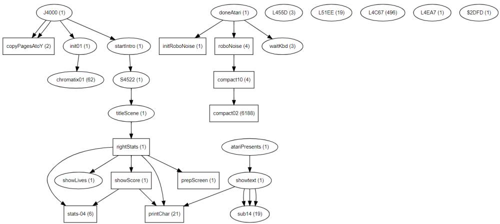

The list of stretches can be shown as a call graph (generated automatically):
Remarks:
  • The address or label shown is the address of the first instruction in the first tile of the stretch.
  • Compact stretches are shown as boxes, non-compact ones as ellipses. Some of the stretches are floating disconnected around. That's a nice TODO list for further refactoring, because it shows where the algorithm is not yet able to connect enough tiles to form meaningful stretches.
  • The arrow is not the call itself but rather pointing from one stretch to another one. Any JSR from inside any of the tiles of a stretch will be shown as just an outbound arrow and any leaps into the body of a stretch would show as an inbound arrow.
  • Consequently, the call graph is a condensed picture of the JSR action happening between the stretches.
  • The call graph does not show JMP yet.
  • I detect RTS jumps which are not balanced by a JSR. The RTS at $51CA is such a "RTS*" because we return to an address after the stash which contains the text to be printed, as explained above for atariPresents and doneAtari. The instruction is marked as RTS* on the "map" sheet, but I don't do anything yet with it.
With the total freedom one has over the stack and execution flow in general, the automated analysis will always fail in certain spots. Currently something like atariPresents is a degenerated stretch: just one tile with one JSR to showText, because the text to show is in the stash below the JSR. Knowing that this is a well-established idiom, the algorithm should be able to build a bridge over atariPresents / stash / doneAtari. This would
  • reduce the visual cluttering by eliminating the red dotted lines,
  • make the listing more organised with more solid red lines, and
  • would also help to cut down the call tree.
Furthermore, sometimes the algorithm tries to be too intelligent. For example, a part of the stretch detection algorithm is to connect tiles ending in an always-branch (+) with the following tile. The assumption behind this is that the branch instruction would fall through eventually. This is usually true, of course, but an SEC/BCS combination (twice in the code) does really never fall through by definition. This shows how progress can be made with the emulator:
  • identify a weird situation in the listing or call tree
  • help the algorithm manually to do the right thing
  • check the newly grouped listing and the call tree
  • implement the rule as part of the automated rule set
For other occurances the algorithm then already knows how to interprete the situation correctly, thus showing correct stretches and making it easier for me to understand what's happening.
The algorithm will change anyways as soon as I introduce post-execution disassembling, i.e. deviating from the rule "only use executed instructions". This will surface lone RTS like the one in $4EA6 and solve the problem of important parts of loop structures (i.e. the INC in $4C65, as pointed out by chromatix). There are also a number of '-' Bxx which never branch but obviously do at least sometimes. It is not possible to get complete coverage without recursively traversing code. That's a bigger change in the algorithm, though, I will have to plan a bit how to do it before changing the current algorithm.
A huge helper for understanding the 6502 details will be fine-grained LD/ST tracking. The issue is less how to do it in the emulator but rather how to constrain it. One of the reasons for this is that Python is simply too slow for doing this kind of on the fly data collection. But the main reason is that the amount of data generated from recording all LD/ST is massive which would actually hurt the understanding. There are certainly many design choices how to approach this conundrum and find a good balance - - any ideas are welcome. :)
Robotron 090311.xlsx [702.58 KiB]
Downloaded 69 times
