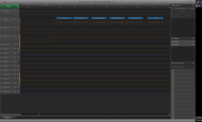

Hi my name is Joseph,
I have one of these MACIII 6502 trainer boards with a keypad display and an applications module.
I managed to dump the rom using a microcontroller.
The board is working fine using the keypad.
My question to you guys is has anyone managed to successfully connect to the board via the CH.A serial port?
I have tried using an ftdi serial to usb converter but I get nothing but garbage, I tried all baud rates from 300 to 115200.
After doing some testing with a dmm I believe that the serial port is probably non standard ie. not rs232.
pin 3 of the 9 pin D-Sub is connected to ground,
TX1 and TX2 of the MAX232 chip are connected to pins 1 and 2.
RX1 and RX2 of the MAX232 chip are connected to pins 6 and 7.

PostPosted: Mon Feb 05, 2024 8:08 am
Online
Welcome Joseph! It would be excellent if you could share your ROM dump, perhaps by attaching a zip or by putting it on Dropbox or similar.
Does your ftdi converter work with other serial connections? Every usb to serial converter seems to have its own quirks and difficulties. I think it's very likely that the serial protocol is a standard one, although it's possible the voltages are not working with your adapter. And it looks like the D-sub pinout is non-standard. Do you have the means to make direct connections with GND and TXD? That would be a good start, and would be enough to see data from the board. (It's very common to mix up TX and RX, so always try both.)
I'd suggest you read off the voltages of each pin of both the A and the B channels, when idle.
Do you have a frequency-counting mode in your multimeter? We can probably find a way to find the baud rate with that.

I thought it probably was 9600, still no luck though, this is the output to the serial monitor. :

This is what the logic capture looks like:
PostPosted: Tue Feb 06, 2024 4:08 pm
Online
Looks to me like your analyser is interpreting an inverted logic. I think the first L-H transition is the start bit. Somewhere in the chain of hardware and software and probing it looks like there needs to be an inversion.

]I tried sending a bunch of ascii 'k's to the board using the serial monitor, my logic analyser interpreted those correctly.

Hmm. Could you clarify perhaps - you've posted two traces. Are they both voltages sent by the Digiac, or both sent by your FTDI adapter, or one of each?
(Also, you pasted a hex dump, but I don't know what it represents: which system sent those bytes? Did the system send the hex dump as we see it, with the printable characters, or did it send the bytes represented within, such as 00, 9E, 96?)

Sorry, the first trace the one on channel 1 of the logic analyser is the txd line coming from the digiac. The second trace, the one on channel 0 is data I sent from the serial monitor on my computer ascii 'k' 0x6b .
the hexdump is the actual data transmitted by the digiac on a cold boot, my serial monitor is capable of displaying the data in hexadecimal.

Ah, thanks. Surprised the digiac sends out a hex dump on cold start. I just might see if I can try to run an emulation.
For the two traces, then, the one where you're looking at the PC sending shows that the logic analyser agrees with the PC on 8-N-1 TTL levels. But I think the other trace shows that the logic analyser doesn't like the RS232 inverted levels with two stop bits. So I think you need to set your PC to send two stop bits, and you need to sort out the inversion somehow.

I agree, I will try it again when the serial card for my pc arrives, maybe the ftdi chip is inverting the signal.

Hang on, are you looking at a UART signal, or an RS232 signal? The polarities are opposite, and the voltages much greater on the RS232. your logic analyser is almost certainly expecting UART levels and polarity.
