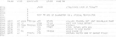

I've finished my section and have only one other mystery concerning a LDY# that I need help with:
File comment: Load Y immediate in PDF source code
was typed in as (line 3261)
          LDX #FHALF               ;GET THE CONSTANT .5
          LDY X1               ;INTO FAC1
which looks like it is missing the # on LDY, however in the listing for the new source code we are developing, it shows this:
3345   A2 96                LDX #FHALF         ;GET THE CONSTANT .5
3347   A0 80                LDY X1         ;INTO FAC1
and that A0 on the LDY line looks like it is assembling as LDY immediate, even though there is no # in front of the operand. Is there supposed to be a # on the operand? I think so. The mystery to me is how the listing has the correct opcode even though I think the source code has an error.
That's the only true error (if it is an error) I found in my section. Kudos to the typists who typed this all in from the PDF listing.

That should definitely be an immediate, Sam. This is where context matters, since the MOVXY routine to which it JSRs uses both registers as "from" and "to" zero-page pointers (by self-modifying). Context awareness is what separates us humans from OCR engines, at least for now.
That missing # (and trust me, it's not the only one!) might have been very hard to debug, because it would silently corrupt zero-page in a way that could take many thousands of subsequent instructions to manifest itself. IOW, good catch!
That is a mystery. Any possibility at all that the assembler has a bug???
PostPosted: Tue Dec 12, 2023 4:50 pm
Posts: 1949
No, Ed. I believe that the .LST file to which Sam refers has been manually massaged by Dave or Nils. Those guys laid A LOT of groundwork before sharing what they had with the team, and they were no doubt cramping up and seeing double at times.
My first thought was along the lines of what BigEd was thinking (bad assembler?), but this was my second thought and it seemed more likely to me. I'll fix that missing # for an immediate operand in my source code section. Thanks.
PostPosted: Tue Dec 12, 2023 8:26 pm
Oh, I see, if the LST file isn't (exactly) a listing, then that's another case!
