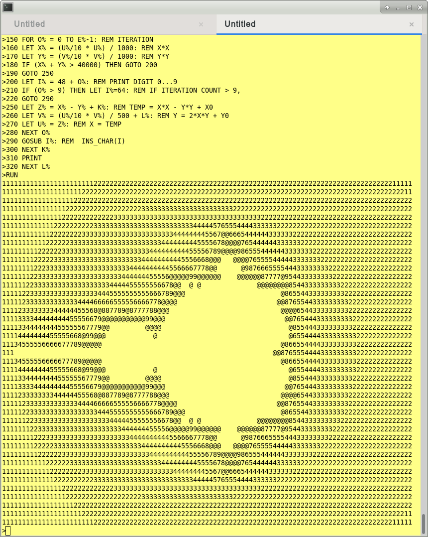

However that does use floating point - the number at the end; 48.21 is seconds running BBC Basic on a 16Mhz 65C02 CPU, but myself and others have used it on various platforms to benchmark (mostly microsoft type) BASICs on 8-bit micros.
I've tried running yours under BBC Basic after converting all variables to integers (I -> I%, etc.) BBC Basic supports 32-bit integers. It's very very slow - I think the main issue is the pixel iteration count being quite large - 200 when you only have 10 "colours" to plot.
So what might be needed is a version that would run with 16-bit signed integers so we could all test it with the various Tiny/Integer BASICs out there including Apple Integer BASIC which is, I feel somewhat neglected these days.
(And as it happens I do have a version that will fit the bill and work in 16-bit integers, however it's currently in BCPL, so I'll make an effort soon to translate it into BASIC suitable for Tiny* systems and other systems that support computed GOSUBs...
Picture of your Mandelbrot running on my Ruby 6502 board under BBC Basic. I didn't time it, but it was several minutes:

Thanks, nice to see. Good point that my iterations was too high versus number of 'colours'. Would be interesting to see if anyone can convert to unsigned 16 bit...
