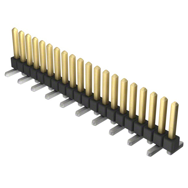

I think someone like Ironwood makes the kind of adapter that you are after. If you want to make one, the bottom side, with the pins to stick into the DIP socket or even a single row receptacle for 0.025" square pins, would be soldered to a surface mount array of alternating pads. These single row headers have alternating pins at right angles to the header pins so that when placed on the surface mount pads it will stand up straight. I think that Samtec, Sullins, or there's a German company that makes these type of headers.
On the top side, a surface mount pattern for the PLCC finishes off the adapter. Only through vias are required to construct the PCB for this kind of adapter.
I think that I saw someone's project on this site constructed in this manner. IIRC it may have been a CPLD adapter described by Windfall (John Kortnik). It may have been on his site.
I've attached a picture of the SMT Sullins S1043E-20 header of the style I described above. I think that it will do exactly what you guys would like to do for a PLCC44-DIP40 adapter.

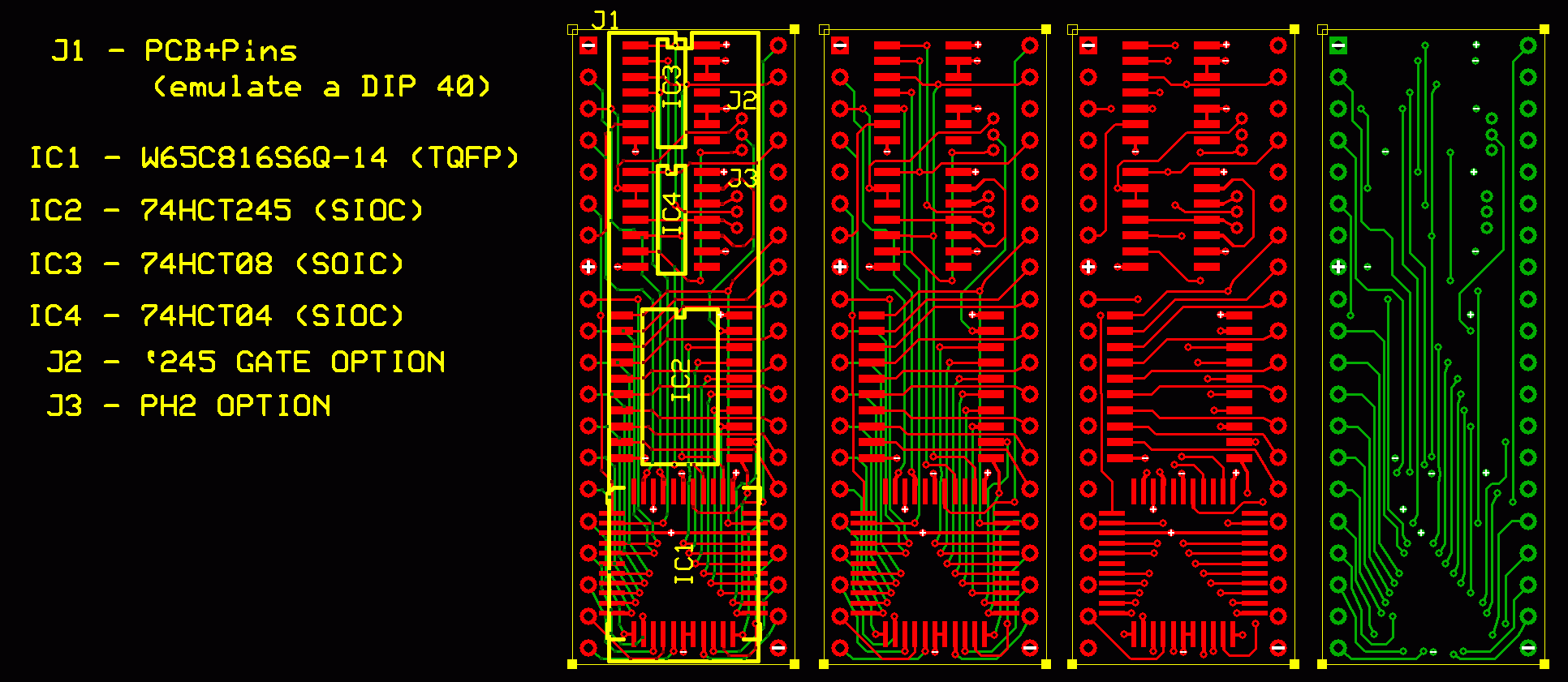

If we're still talking about Daryl's substitute hybrid for the now-unavailable 65802, it has four ICs on it, on a board made to take the space of a 40-pin DIP and plug into a 6502 socket in existing boards. Here's the layout, from his website:
IOW, it's not just putting a single PLCC into a DIP socket. Also, .025" square posts are too thick for IC sockets.
I use SMT for my PCB layouts for work, but I never do connectors in SMT, since I've seen them rip the foils away from the board when any force was put on them. Connectors basically need to be thru-hole because of how that has the effect of riveting them to the board. Thru-hole connectors also take less board space, because they don't have to have wings sticking out the sides.
