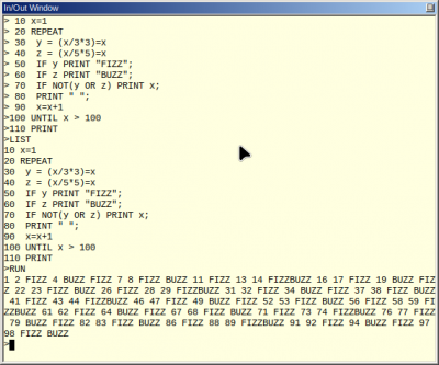

PostPosted: Tue Oct 24, 2023 9:22 am

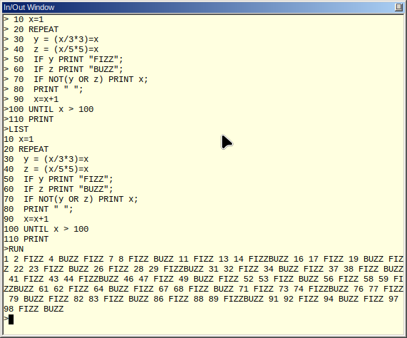

As you can see here, the FizzBuzz program I wrote earlier is now running. It takes about 2.5 million cycles, which isn't too bad considering this really isn't a performance-oriented interpreter.

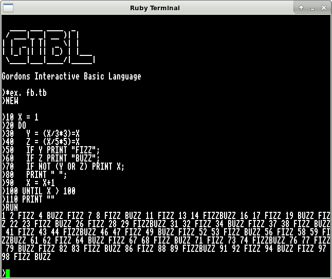

PostPosted: Tue Oct 24, 2023 10:28 am
Posts: 1488
Excellent!
Here it is in my TinyBasic:
With an interesting note... In the old TinyBasic documents I had, the NOT operation was defined as Ones Compliment... So that's what I implemented... And it made my initial version of this fail... Because at (e.g.) X=3 :-
(Y OR Z) returnes (1 OR 0) which is 1 and NOT 1 is -2.
True/False is defined as Non-zero/Zero, so
NOT (1 OR 0) is NOT 1 which is -2 which is TRUE.
Which is correct, but not the expected result...
I changed my implementation of NOT to make 0 -> 1 and anything non-zero return 0 and it worked.
Or did it - which was right? It's an interesting conjecture...

I adopted the BBC BASIC convention of making "true" results from comparison operators be -1. This means that bitwise operators can also be used for logical operations, including NOT. I don't think it requires significantly more code than producing a 1 result, as for both "false" and "true" a single byte value is replicated to all four result positions.
C doesn't do this - it has separate operators for bitwise and logical operations. So bitwise complement is ~ and logical complement is !.

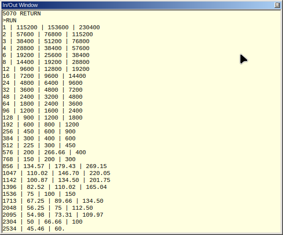

PostPosted: Tue Oct 24, 2023 12:31 pm
Another program showing off interesting features of the interpreter. Note that the code is not presented in execution order, but when pasted in it will effectively be sorted by line number. This takes approximately 1.2 million cycles to complete, and then executing the program takes several million more.

The main features thus demonstrated/exercised are the memory management for program code, the use of 32-bit internal arithmetic to support fixed-point, and nested subroutine calls. In a more complete and conventional BASIC interpreter, this would be a natural place to use DATA and READ, which I don't have - nor is there an END or STOP, but a contrived GOTO past the end of the program also works.
The output is a table of the baud rates for my "improved ACIA" proposal:

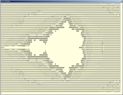

PostPosted: Tue Oct 24, 2023 3:51 pm
And, what I'm sure you've all been waiting for:
   0 S=2048
  10 A=S*-21/10
  20 B=S*3/2
  30 C=S*3/2
  40 D=S*-3/2
  50 E=200
  60 F=(B-A)/128
  70 G=(C-D)/48
  80 L=C
  90 REPEAT
 100  K=A
 110  REPEAT
 120   V=0
 130   U=0
 150   O=0
 160   REPEAT
 170    X=U*U/S
 180    Y=V*V/S
 190    V=U*V/(S/2)+L
 200    U=X-Y+K
 210    O=O+1
 220   UNTIL O >= E OR X+Y > 4*S
 230   IF O<E AND O>9 VDU 64
 240   IF O<10 VDU O+48
 250   IF O=E VDU 32
 260   K=K+F
 270  UNTIL K >= B
 280  PRINT
 290  L=L-G
 300 UNTIL L < D
I haven't got a timing for this, but it does run and produce reasonable results. I did have to correct a serious oversight in the division routine, related to the handling of negative arguments…

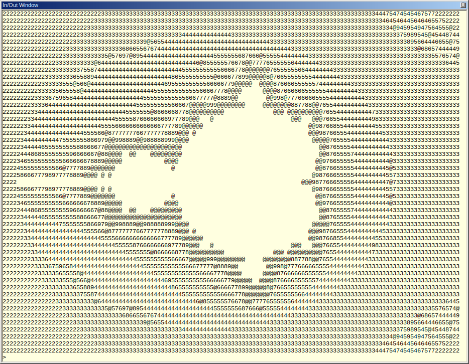

PostPosted: Tue Oct 24, 2023 5:04 pm
Posts: 741
Hooray! There are some overflows though, I think, e.g. the noise in the top and bottom right corners, and between zones 3 and 4. I'd guess U*U/S or V*V/S is overflowing before the division, so you might need to do range checks on U and V as well, perhaps, and decide how to act if they're already above a threshold.
PostPosted: Tue Oct 24, 2023 5:32 pm
I have a suspicion that those aren't really overflows, but might be due to a subtle bug in the interpreter which would only show up with large-magnitude numbers. The near-threshold iterates in those regions should not be overflowing 32 bits with the scale factor I've selected, but might overflow 24 bits. I'll investigate…
EDIT: Well, there's no problem in the intermediate values, but it's more likely that the stored variables are overflowing. With some extra bailout tests on the inner loop, I can successfully hide these, though the shape of the exterior gradient changes.

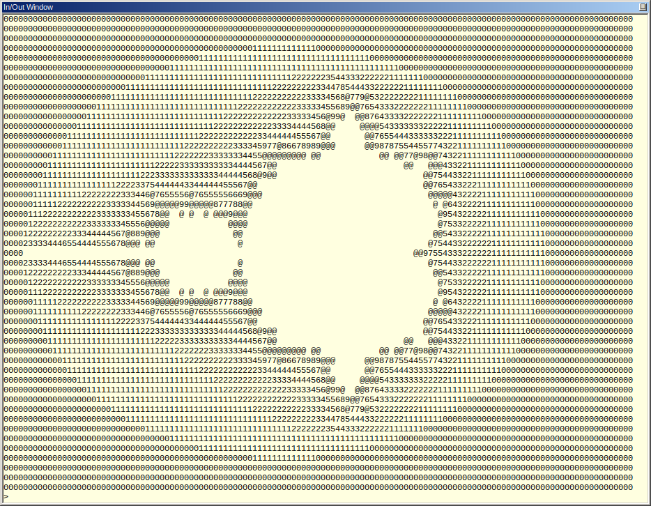

PostPosted: Tue Oct 24, 2023 9:27 pm
This is much better:
   0 S=4096
   5 T=S*4
  10 A=S*-21/10
  20 B=S*3/2
  30 C=S*3/2
  40 D=S*-3/2
  50 E=200
  60 F=(B-A)/128
  70 G=(C-D)/48
  80 L=C
  90 REPEAT
 100  K=A
 110  REPEAT
 120   V=L
 130   U=K
 150   O=-1
 160   REPEAT
 170    Z=(U*U-V*V)/S
 190    V=U*V/(S/2)+L
 200    U=Z+K
 210    O=O+1
 220   UNTIL O >= E OR U*U+V*V > T*S
 250   IF O=E VDU 32
 260   K=K+F
 270  UNTIL K >= B
 280  PRINT
 290  L=L-G
 300 UNTIL L < D
