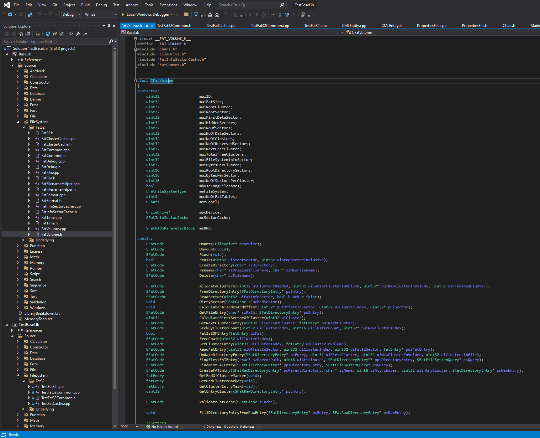

then if you're brave take a look in:
FatVolume.h
FatVolume.cpp
that finally do the work to deal with the awful mangled cluster system that is FAT.
