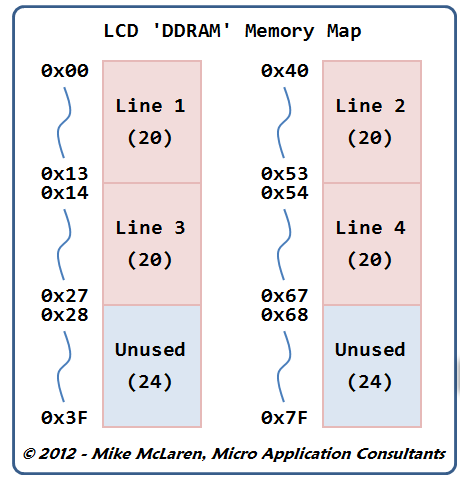

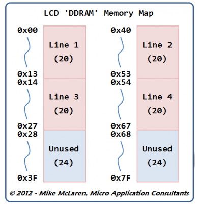

About the display size:  Common bigger ones are 2x24, 2x40, and 4x40.  The 4x40 is interfaced like two 2x40's, with all the bits common except the E (enable), of which there are two, one for the two upper lines, and one for the two lower lines.  There used to be 1x80 and 2x80 made for the tail end of the typewriter market, so you could type a line and preview and make corrections before actually making it go on the paper; but that market is long gone and so are those LCDs.
About arrows and custom characters:  You can have up to eight custom characters at a time (16 if it's a 4x40, 8 in the upper two lines, and, eight more in the lower two lines).  I've made all kinds of custom characters for them.

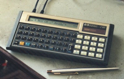

My HP-71 computer shown here
has a 1x22 LCD.  I have the 80-column video monitor for it, but for portable use, when I was using it a lot, I wrote a rather full-featured text editor for use with only the built-in display, that allowed me to nimbly move around a large file.  It may seem like you're looking at your work as if through an old-fashioned keyhole; but if you make it so you can move that keyhole around your work nimbly, it works surprisingly well.

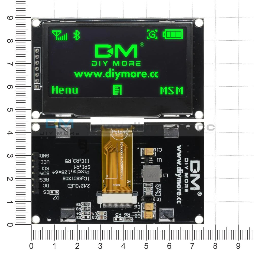

I've found the DIYMORE 2.42" OLED displays very good indeed. They're a seven pin SPI connection so easy to interface but as they're a pixel-addressable 128 x 64 graphics display (1309 controller) they're a bit harder work to drive. For text you'll need to include a font (vertical, just to confuse you!) and of course it takes a few more writes per character... but they are usable at eight lines of text though prettier at four lines (in both cases, of twenty characters).
They're available all over the bay; the last ones I bought were about thirteen quid each though single units are often offered at around twenty.
Somewhere I have a datasheet for the part but I can't immediately locate it :)
2.42" OLED display, nice! I've worked with 0.96" 128x64 I2C, even able to display animated video, but 2.42" would be very nice. I'm ordering one to try it out.

I found the technical PDF for the display; attached.
The initialisation code I use (In C, but obvious and linear) - ssd1309_write_command(xx) does exactly what you'd expect and sends the byte to the display via SPI

Paganini wrote:
... I thought of yet another way to manage the display that I think might be even better. That is to use an actual frame buffer. I could have an 80-byte array somewhere in RAM that corresponds to the 80 screen locations on the LCD. All of PAGMON's output would be writing ASCII characters to the frame buffer. Updating the display would simply involve dumping the frame-buffer to the LCD, one character at a time. There would be no need for meticulously checking boundaries, and all the fussy address translation could be done in this one routine. This would also make PAGMON more portable. The only downside I see is that the LCD is kind of slow and might not be able to keep up with having its entire screen redrawn rapidly and constantly. I really like this idea, though, so I might put it together this evening and see how it works! :)
If it may be of any help... I tested an LCD "frame buffer" method awhile back on a PIC uC and it worked quite well but I refreshed the display from the buffer one character at a time via an interrupt driver. In my main program I found it easy to set VTAB and HTAB position and to write LCD data using the buffer (no LCD inter-character write delays). Here's an excerpt of the interrupt driver (C) which I hope you may find useful.
Regards, Mike

Michael wrote:
If it may be of any help... I tested an LCD "frame buffer" method awhile back on a PIC uC and it worked quite well but I refreshed the display from the buffer one character at a time via an interrupt driver. In my main program I found it easy to set VTAB and HTAB position and to write LCD data using the buffer (without LCD inter-character write delays). Here's an excerpt of the interrupt driver (C) which I hope you may find useful.
Very cool! I like your memory map. That's a really good way to visualize the LCD address space.
I actually went ahead and implemented a frame-buffer this evening. It only took a few hours, mostly removing LCD cruft and renaming some things. I like it a lot! It has made the code cleaner and more modular. The monitor only needs two wrapper routines to handle I/O now; everything else goes to the framebuffer. Mine isn't as fancy as yours though; I treated the framebuffer like an 80 character array and used a single pointer to index it. The frame refresh routine just gets called whenever something changes. The LCD doesn't seem to have any trouble keeping up though. It's not flickering, or anything.
