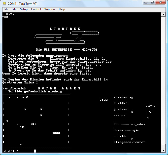

PostPosted: Sun Nov 13, 2022 5:01 pm
Posts: 1076
I have not figured out how to xmodem the large BASIC.ASM file to CPM65, but I ported the BASIC.ASM to CA65 assembler and assembled it on my PC. It is working well enough to run first part of the StarTrek. I took German in high school 50 years ago, I think I may need to look up a few words! :lol: :?
PostPosted: Sun Nov 13, 2022 6:50 pm
Posts: 8183
You can almost figure it out, even if you don’t know German, as long as you are familiar with the Star Trek story. (Who under the age of 90 isn’t familiar with it? :D) For example, Sternentag is “star date.”

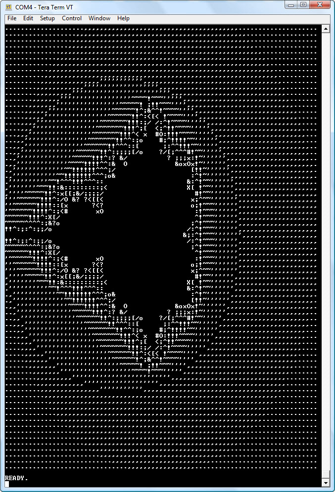

StarTrek was my very first computer game; I was green with envy watching graduate students with extra computer time playing it in the computer room. It motivated me to be extra careful with homework assignments so I'll also have extra time left after homeworks were done to play StarTrek.
Dietrich,
I ran the Mandelbrot benchmark on your BASIC:
10 MAXITER=20
20 LET C$=" .,'~!^:;[/<&?oxOX#  "
30 FOR Y=-39 TO 39
40 FOR X=-39 TO 39
50 CREAL=X/20
70 CIMAG=Y/20
80 ZREAL = CREAL
90 ZIMAG = CIMAG
95 COUNT = 1
100 ZM = ZREAL*ZREAL
105 ZN = ZIMAG*ZIMAG
107 ZL = ZM+ZN
110 IF ZL>4 THEN GOTO 170
120 Z2=ZM-ZN+CREAL
130 ZIMAG=ZREAL*ZIMAG*2+CIMAG
140 ZREAL=Z2
150 COUNT=COUNT+1
160 IF COUNT<MAXITER THEN GOTO 100
170 PRINT MID$(C$,1+COUNT,1);
180 NEXT X
185 PRINT ""
190 NEXT Y
200 END
On 29.5MHz CRC65 it ran 44 seconds. Here are comparison to other BASIC:
DOS/65 (29.5MHz) MicroSoft BASIC 51 seconds
DOS/65 EhBASIC 45 seconds
DOS/65 BASIC compiler 24 seconds
29.5MHz Z80 CP/M Microsoft BASIC 115 seconds.
PostPosted: Mon Nov 14, 2022 10:31 am
Posts: 1412
Dietrich,
10 MAXITER=20
30 FOR Y=-39 TO 39
40 FOR X=-39 TO 39
50 CREAL=X/20
70 CIMAG=Y/20
80 ZREAL = CREAL
90 ZIMAG = CIMAG
95 COUNT = 1
107 ZL = ZM+ZN
120 Z2=ZM-ZN+CREAL
140 ZREAL=Z2
150 COUNT=COUNT+1
180 NEXT X
185 PRINT ""
190 NEXT Y
200 END
Some time back I took a variant of that code and adapted it to a format that had a bug corrected and one that would run on all the BASICs I had access too as a crude way to benchmark them - what it's really testing though is floating point performance and not much else.
The code is here:
https://unicorn.drogon.net/mandel.bas
with expected output:
https://unicorn.drogon.net/mandel.txt
The time on that output (48 seconds) is BBC Basic 4 on my Ruby system which is a 16Mhz 65C02. Scaling the times to your 29.5Mhz system, I'd expect it to run in about 28 seconds - which probably demonstrates that even with a compiled BASIC, the overhead is still the floating point calculations..

PostPosted: Tue Nov 15, 2022 4:13 am
Posts: 1076
The code is here:
I've learned from previous benchmarks that BBC BASIC is very fast. Taking your code and runing it on 29.5MHz CRC65 in CPM-65 BASIC and DOS/65 BASIC I have these results:
DOS/65 Microsoft BASIC                   56 seconds
CPM-65 BASIC                                49 seconds.
Ruby BBC BASIC scaled to 29.5MHz,         26 seconds.
Running to 29.5MHz requires a small minimal 6502 SBC. I know CRC65 won't run 29.5MHz plugging into a back plane driving another board. 25.175MHz seems much more stable which is the 60Hz VGA clock. I have CRC65 plugged into backplane driving vido board, quad serial board and blinking light display board while running at 25.175MHz.
PostPosted: Tue Nov 15, 2022 8:02 am
Joined: Wed Jan 01, 2003 6:32 pm
Posts: 32
That is no surprise. My BASIC was disassembled and rewritten from a BASIC, I extracted from a CBM 8032 in 1982. So it is essentially a Microsoft BASIC.

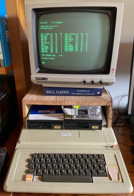

I just published a first port of CPM-65 on the Apple II, see https://github.com/Dietrich-L/CPM-65-for-Apple-II
A 80 col card is required.
Feedback is welcome

PostPosted: Wed Jul 26, 2023 4:05 pm
Posts: 993
Very cool!
What are you using as timer source or Interrupt source? My understanding is the Apple II does not have timer interrupts up until the IIe
PostPosted: Thu Jul 27, 2023 7:18 am
Posts: 32
fachat wrote:
Very cool!
Well, CPM-65 does not need any timers or interrupts, except for the debugger, which uses the BRK interrupt.
My own system, a heavily modified Elektor Junior Computer, uses timer interrupts for various purposes, e.g. disk access timeouts, and also offers BIOS functions for timers to be used by any apps. The Apple II version doesn‘t have those though. Its actually a shortcoming of the original design.
