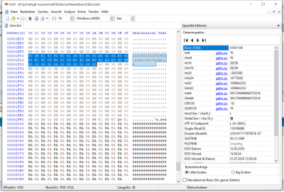

But i didn't get that working. In my asm file i have some jump tables just like this:
jump_table:
.segment "JUMPTABLE"
   .org $FF00 ; STROUT output string, A = high, X = low
   jmp do_strout
   .org $FF81 ; SCINIT Initialize "Screen output", (here only the serial monitor)
   jmp do_scinit
   .org $FF84 ; IOINIT Initialize VIA & IRQ
   jmp do_ioinit
   .org $FF87 ; RAMTAS RAM test and search memory end
   jmp do_ramtas
   .org $FF8A ; RESTOR restore default kernel vectors
   jmp do_restor
As you can easily see, the individual jumps are not continuously connected. If I now specify the segment for the table, the 1st jump is placed correctly, but the others specified with .org are not. However, everything is correct in the list file. So I suspect that the linker is not configured correctly here. How do I set this up correctly?

Thats the point, but in the linker generated bin file, all jump are directly behind each other, ignoring the .org directrive.
With retro assembler (which didn't need a linker) it work like charm. But retroassembler is a assembler only.

I don't know why you navigated to $1F00 in the screenshot. That's quite the distance from $FF00 where the first JMP opcode should be.
PostPosted: Fri Aug 26, 2022 7:33 am
Joined: Wed Jul 27, 2022 6:14 am
Posts: 54
because the eeprom base adress is at $e000,
so $1f00 +$e000 = $ff00

What does the line containing "JUMPTABLE" in your mem map config file look like?
PostPosted: Fri Aug 26, 2022 7:46 am
Posts: 54
THis is the full config file

   JUMPTABLE:  load=ROM, start= $ff00, type= overwrite;

Not sure; since you know the first jmp is in the correct spot, can you try putting each jmp in its own segment and specify the addresses you were using with .org in the memmap configuration? JUMPTABLE1, JUMPTABLE2, etc.

But than i double the effort, have to insert .segment and .org part in asm, and a segment in the configuration...
I'm looking for an easy solution for this...

If you use .segement you don't need .org
I have something similar for the ROM of my 65816 SBC. Once I get home I can see If I can get your example to work

But the effort for this, creating a segment for every bios routine jump, is quite high for such a simple requirement.
I open an issue to the developer of CA65 (https://github.com/cc65/cc65/issues/1841) maybe they have another simple idea.
Otherwise maybe CA65 is the wrong tool for this and for me... i like KISS

Could you add in a DB or similar 'declare bytes' padding to fill in between the JMPs? I suppose that's a little manual.

i commented on the github issue suggesting basically what BigEd said, ca65 has the ".res" (aka reserve) directive which allows you to insert x amount of bytes directly where you placed it in the assembly file.
using it the jumps can be pushed apart without messing with segments, but obviously it takes a bit of work as you need to do the math to know how large the gaps should be.
