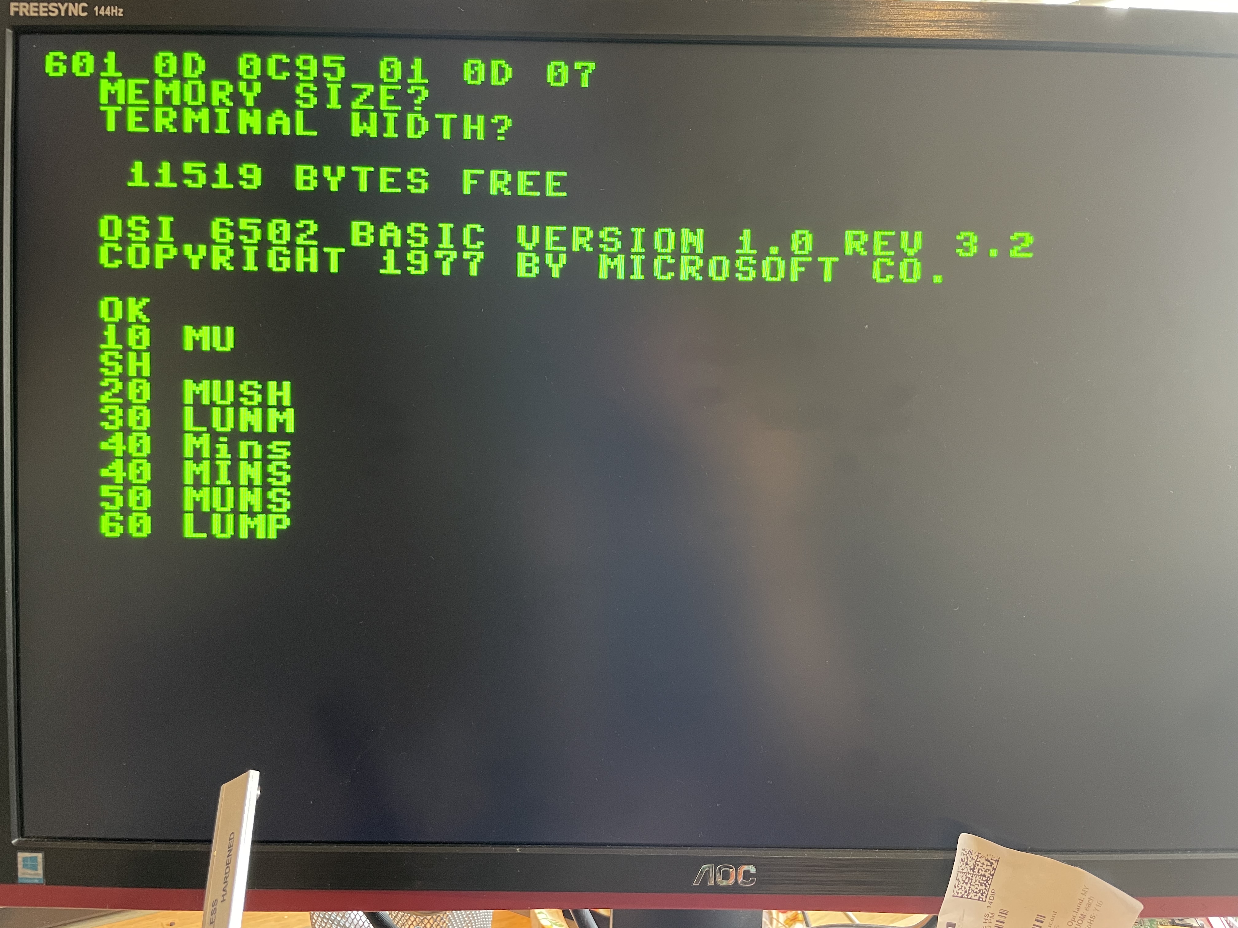

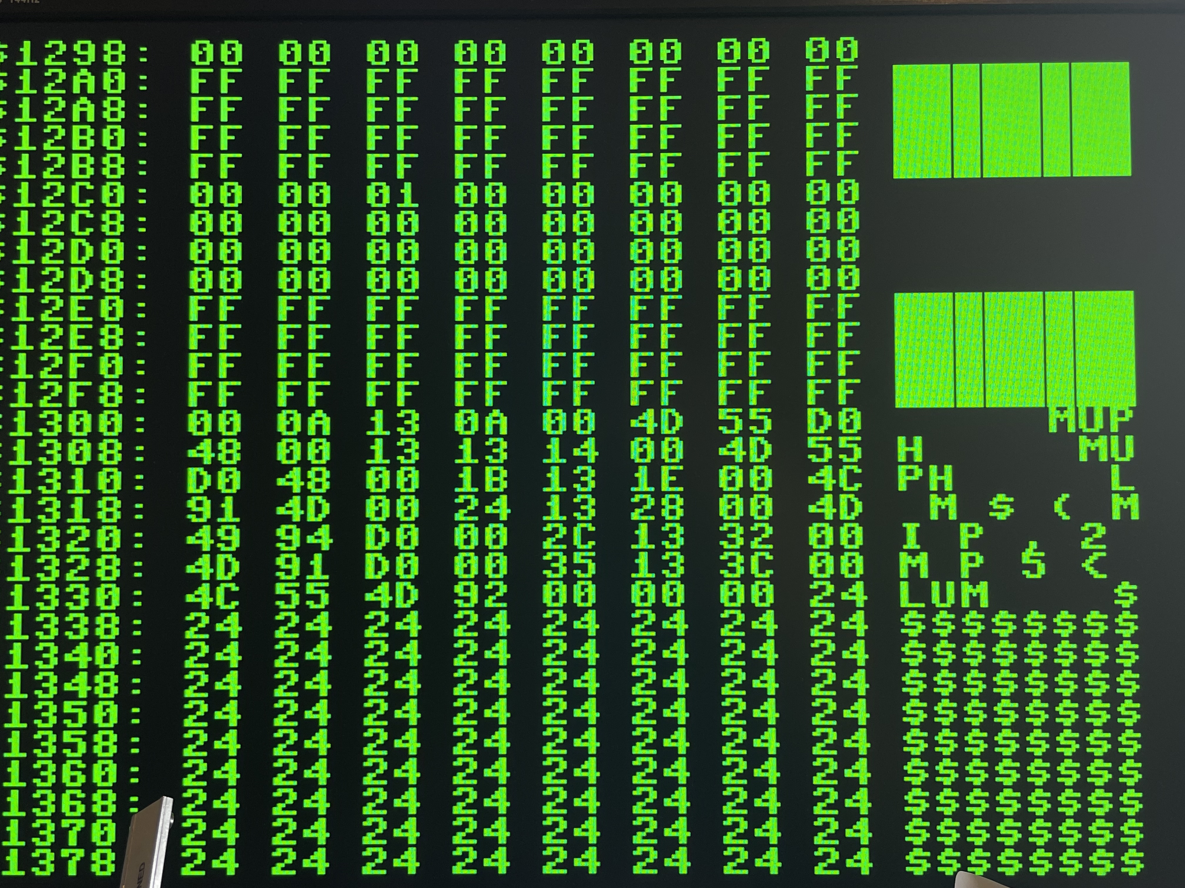

Posts: 182
Even though I’m careful to save registers it looks like it’s writing numbered lines wrong

Well that didn't help much. I got some crap moved out of ZP that didn't need to be there though and I can move everything around at will.
One thing I find weird is what get's written to RAMSTART2 when I try to run a LIST and nothing else. (And get a syntax err)
When inspecting my RAMSTART2 at $1300 it shows 00 00 00 24 4C 00 00 00 00 00 24 24 24 24 24 24 24 (24 is test pattern and continues for rest of RAM).
I have a feeling that's not what should be there and that could explain the SN ERR... But what does it mean? Maybe tokens really don't load?

Still desperately trying to debug this..
Can anyone explain what's going on below?
I've set my timer IRQ to display the contents of INPUTBUFFER every half second-ish - works great and doesn't affect anything.
1) When typing an unnumbered line it ends up in the input buffer just fine.
2) When I press return the input buffer seems to be tokenized ... or something - I've decided to save the loads from PARSE_INPUT_LINE to see what actually happens.
If I type in LIST LIST LIST LIST, the input buffer changes to this on return(HEX):
4C A8 20 4C A8 20 4C A8 20 4C A8 00
If I save a numbered line (10 LIST) on the c1p emulator and peek memory I get this(DECIMAL):
0 7 3 10 0 153 0 0 0
153 == $99 == 25 decimal ORA $80.
When counting down the list of keywords I see LIST is #26... Hmm.. Maybe it means nothing. But certainly that the LIST token should be $99.
This is what I get when entering a numbered line no my SBC with (10 LIST) (HEX):
00 08 13 0A 00 4C A8 00 00 00
Somehow LIST seems to be tokenized into two bytes - 4C A8... Which makes no sense to me.
000226r 3  B5 00                lda     INPUTBUFFERX,x
000228r 3  9D 00 05             sta     $0500,x ; <--------Debug line
The above from the PARSE_INPUT_LINE routine gives this dump at $0500:
00 00 00 00 00 00 00 00
00 00 00 4C 49 00 00 20
4C 49 00 00 20 4C 49 00
FF 20 4C 49 FF FF 00 FF ; <-- This line seems to indicate the FF's are uninitialized and X has skipped them.

PostPosted: Fri Aug 19, 2022 3:43 pm
Posts: 388
Location: Minnesota
At first glance it looks like you're saving the input buffer each time the routine goes back to fetch another character (that's not between quotes or in a REM statement). So it gets overwritten each time, and you don't really see how it progresses.
It might be more helpful to start by saving the contents of the input buffer just twice, to two different locations, one just before tokenization and once just after it ends, so you can compare "before" and "after".
You actually wouldn't need to save anything afterwards, since the result would be in the input buffer anyway, but putting them next to each other in memory might make for easier comparisons.
After that you could, if it seemed helpful, save the buffer each time the routine goes back to the top, at increasing memory locations, so you can track the progress at each step and see if it's what you expect. But that's more work, and might be unnecessary if the first step solves the problem.
Or, hmm, instead of saving the buffer, at the top JSR to a subroutine that prints out the buffer contents and then waits for a keypress to return. That might be quickest.
PostPosted: Sat Aug 20, 2022 9:08 am
Posts: 182
Using LIST as a test the input buffer correctly contains LIST followed by null's.
Considering it has worked before that leaves variables, x, y and status register.
X is loaded from TXTPTR (should check that. Edit: Was $13 == start if inputbuffer as expected - should doublecheck it's not supposed to be something else)
Y is loaded immediate to $#4
Status register is overwritten pretty quickly
X is used as an index into the input buffer
Y is used as an index into the TOKEN_NAME_TABLE
There really not that many things that can break here.. Seems like the only things that can be wrong going in is TXTPTR or the TOKEN_NAME_TABLE.. Maybe..
