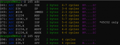

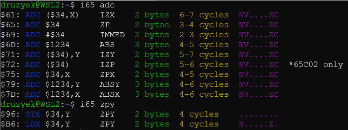

A few months ago, while working on a 6502 emulation project, I kept having to look up little details like which addressing modes certain instructions support and whether they modify certain flags, so I made a Python program for Linux called i65 to easily look them all up (GitHub link). i65 adc, for example, shows all the adc op codes, addressing modes, size, cycles count, and flags they affect (screenshot below). i65 zp shows the same info for all the instructions with zero page addressing. If the program is started without any arguments, it waits for input and shows all instructions that match what you type until it's narrowed down far enough to show the full information. The Kowalski simulator has this, and I wanted to have something similar on Linux.

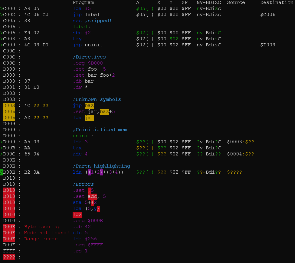

The assembler I came up with (GitHUb link) reassembles and simulates as much of the source as it can while you type, so you don't have to go through the whole cycle of assembling, fixing errors, re-assembling, and simulating (screenshot below). It somewhat resembles Compiler Explorer in that regard. There is no user input or output, and it doesn't produce binaries, so it won't replace Kowalski, but for testing snippets for my emulation projects, I think it works a lot better. The assembler has syntax highlighting including marking unknown symbols in yellow and syntax errors in red. The simulator keeps track of uninitialized memory and marks anything loaded or calculated from it with "?".

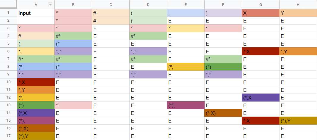

The address mode recognition and syntax checker for the assembler were especially interesting to work on. Rather than try to write out a state machine with a huge number of if statements, I mapped everything out in a spreadsheet. Once that was done, it was simple to have the spreadsheet format the data into a structure that can be directly pasted into the Python script. The Python code to advance the state machine is then very compact and basically just does a look up into the data structure. For example, starting with an instruction like LDA ((3)+2,X), the state machine would take it's current state ("none" since nothing has been evaluated yet) and look up the next state based on the first input symbol which is "(". In the screenshot below, column A holds the current state (A2 for "none") and row 1 holds the input state (D1 for "("). The look up specifies the next state as D2 which is "(". A look up yielding "E" means the combination is invalid, as in E2 where starting an argument with "," is always invalid. On the next iteration, "(" is the input state (A5). One special rule is that any parentheses after the top level are treated as part of an expression since they don't specify addressing mode. Any part of an expression including numbers and operators is coded as "*" in the column, so the next state is given by looking up A5 and B1 which yields "(*" from B5. Proceeding like this, the states are:
LDA ((3)+2,X)
1.  (          A2,D1  = D2:  "none" + "(" = "("
2.   (         A5,B1  = B5:  "("    + "*" = "(*"
3.    3        A8,B1  = B8:  "(*"   + "*" = "(*"
4.     )       A8,B1  = B8:  "(*"   + "*" = "(*"
5.      +      A8,B1  = B8:  "(*"   + "*" = "(*"
6.       2     A8,B1  = B8:  "(*"   + "*" = "(*"
7.        ,    A8,E1  = A12: "(*"   + "," = "(*,"
8.         X   A12,G1 = G12: "(*,"  + "X" = "(*,X"
9.          )  A14,F1 = F14: "(*,X" + ")" = "(*,X)"
The result after all symbols are parsed is "(*,X)" which can be matched to the addressing mode for generating the machine code. This method lets me handle tricky cases like LDA (3)+2 or LDA (3)+(2). A similar state machine handles syntax checking so I know anything passed to the addressing mode state machine is correct. This method also lets me tell the difference between * as multiplication and * as current address (ie JMP *), as well as - as subtraction and - as a minus sign.
