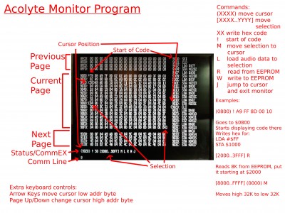

Hello everyone! I want your critiquing and criticism. I want to know what is good and what is bad about my monitor program. Attached is a picture with guiding points of interest.
The main idea is that you type these commands, and it reads/writes/modifies hex code. The disassembler on the side is new, but very useful. I am planning/hoping to add an assembler as well, just another command and a lot of code essentially. You can also use the arrow keys and page up/down to move the cursor around. Kind of a mix between straight command-line and a "GUI" if you can call it that.
I've been researching this stuff for a bit. Wozmon, Tedmon, Supermon, etc. A page like this is very helpful to see what features I should be aiming towards:
https://www.c64-wiki.com/wiki/TEDMON
I know that mine is not like that, and it will never be. My video memory is write-only, so I cannot easily just move back up a line or two and resubmit it like you could in Tedmon or some such. That is why I'm focusing on displaying a 'GUI' style with a cursor and all that. Plus that seemed user friendly to me.
The goal here is to make something more-or-less self sufficient. Stand alone. The user can write their own code, save it for later, but also load and run files from another computer, etc. Like a mini-operating system. It would replace what would usually be filled with BASIC or some such. I also want it as user friendly as a monitor can be. Less technical, more ease of use. A big example of this is using the arrow keys to move the cursor around.
What do you suggest? What things would make this better? It could be aesthetic, it could be functional. Some examples you could critique could be:
- The letters/symbols for commands. Or even, my choice of commands, or lack thereof.
- The layout on the screen.
- Even the way this is using the cursor and selection conceptually.
I know I'm asking pros here, but put your newbie hat on for a minute and tell me: What would make this good to use? Better? Easier?
Thoughts? Comments? Critiques? Criticisms? You won't hurt my feelings, I'm just wanting a good end-user product.
Thank you everyone, I appreciate your insights.

TEDMON is Commodore’s adaptation of Jim Butterfield’s Supermon 64. The version found in the C-128 was not called TEDMON, according to Fred Bowen and actually was closer to Supermon 64 than was TEDMON.
Unless you plan to incorporate a full-screen editor into your firmware, I recommend you seek a copy of the Supermon 64 source code and study it in detail. Trying to decipher some of Commodore’s mods to Supermon 64 will be an exercise in patience.
BTW, when I wrote Supermon 816, I copied the user interface of Supermon 64, which had been around in one form or another since the 1970s. I saw no reason to deviate from something that every Commodore assembly language programmer and his pet donkey had used since antiquity.
I strongly advise against modeling WozMon. It was not one of Wozniak’s sterling programming efforts and, in fact, is a sort of “black sheep” in today’s 6502 world.

The design looks reasonable to me - navigation looks sensible, as does the layout.
I'd advise looking as widely as possible at other monitors - not restricted to Commodore, or to Apple, or even necessarily to 6502.
I suspect it's better to start with useful functions which are feasible to implement, and then decide on which command letters to use - if indeed the choice of single-letter commands feels right. That is, don't start with 26 letters and see which commands they might stand for.
It might be worth thinking how to display the story of machine states if and when you implement single-stepping.
WOZMON is notably limited, but in my opinion was a perfect mate to the hardware on which it ran (256 bytes of ROM, no cursor controls except CR). The "address-first" command structure is a matter of taste, and kind of reminds me of RPN in a pleasing way. Would your "black sheep" opinion apply to classic HP hand-held calculators as well? There's nothing wrong with having a personal opinion, as long as it's characterized as such.

Well, asking for a critique can be dangerous, but I'll take an initial stab at it. I would echo some of the existing comments and also agree with BDD on doing a deep dive on existing code like Supermon 64 and others.
The user interface will most likely be something that you're comfortable with. I wouldn't say you should pattern it after another monitor, but as Ed noted, look at other monitor programs to get an idea on how the UI was done and what functions were included. As far as functions go, I'd suggest making a list of requirements you think you will need to make working with the hardware easy and functional. Having a consistent command structure is also nice, as many commands will have similar input parameters.
I did take a look at your source code.... I will take a "stab" at it.... it's not very useful, in my opinion of course. What I see here is a lack of structure, virtually no comments and very little to suggest what is being done in the routines. You might want to consider creating a separate BIOS for your hardware and make those routines accessible via a JUMP table, which is quite common. The BIOS would have a clearly defined set of functions against the hardware that can be used by a Monitor program or other applications/utilities. The Monitor part could also be written as a separate program that only uses the BIOS to communicate with your hardware. It also could have a JUMP table to make core routines accessible from other applications/utilities.
I would recommend getting copies of some existing manuals, such as the "6502 Assembly Language Subroutines" by Leventhal/Saville. You will find many useful bits of code there which you can likely adapt to what you need, or at least get a better idea on how to write certain types of routines. Going back to your code, there are so many sections which are a "brute force" approach, i.e., sending a mnemonic to your screen. You load the A reg with each character and send it through a routine. Writing a routine that sends a string of characters would be most useful here and significantly reduce your code size.
It would be useful to include a help screen that simply shows what the commands are with some basic input parameters. Commenting your code will be useful to you in the future, when you go back and look at it some years later. Here's a small snippet of code from my C02Monitor that is the input routine that checks for a command and calls the appropriate routine from a command table for execution.
I would note that many of us old guys tend to use shorter labels, in my case, mainly because the assembler I used back in the 80's had limits on how long a label could be, so most folks simply looked at making them short and trying to make them somewhat obvious for what they are... but sometimes you have to punt on these. But in any case, I tend to comment heavily, especially in my BIOS section. I also add clock cycle counts for key code sections in the BIOS that touches the hardware, which comes in pretty handy at times for debugging problems elsewhere. An example of this is:
One last bit of input from my side.... I tend to put limits on the amount of space any code should be. For my current C02 Pocket SBC, I have a limit for the BIOS of 2KB less the I/O window, which is 160 bytes located at $FE00. I also have a JMP table at $FF00. The BIOS code starts at $F800. For the Monitor code, it has a limit of 6KB, from $E000 to $F7FF. There are also limits on how much Page Zero space is used for the BIOS and Monitor. I also think you might want to break up the code a bit... separate modules that you can link together, one being a set of code defines and equates for your hardware addresses, page zero usage, etc. Feel free to grab any of my code from my GitHub page and use whatever you like. You'll find some areas of my code that others (like Mike Barry and BDD) have suggested as improvements and were implemented.
Finally, have fun doing this... and comment everything, as years down the road, when you look at your own code, you'll be scratching you head asking yourself what it all does

I kind of like the screen layout, but I'm a bit confused by what it's actually showing. I see three points - a page and disassembly start at $9000, a cursor at $9020 and a selection at $9080 - and I'm not sure why they're distinct. I would expect that disassembly would start at either the cursor position or the selection start. Maybe a separate command to "disassemble from cursor position" to be used after "move cursor"?
The selected area is fairly clear, but might be even more clear if in inverse video. Is there anything I can do with a selection, once I have one?
I would not immediately associate "L" with "load audio file". Maybe "A"? I associate "X" with "exit monitor" and "G" for "go to address and start execution".
"R" and "W" are pretty clearly associated with a fixed (and implied) EEPROM address. That being the case, why not also have a fixed RAM buffer to read and write to and from? Is there any situation in which it would be an advantage to have a variable RAM starting address? I certainly do not know but suspect that in practice you already pretty much always use the same RAM addresses already (at least I would). If so, they're easily hard-coded and can be changed by anyone who has access to the source code.
You might think about an option to display memory as ASCII or ISO-Latin-1 (if your character generator supports it), so any character strings are more readily picked out.
