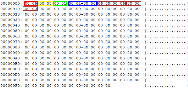

LUCIDATA sold Pascal language systems for the 6800 FLEX and 6809 FLEX and UniFLEX environments. Their compiler generated programs in the form of P-code for a stack machine to be interpreted by their run-time package.
One of my projects is an effort to analyze the P-code structure and interpreter with the ultimate aim of eventually producing an interpreter running on the 6502. Because their compiler is supplied in P-code running on the same interpreter, it is hoped that when the interpreter is done, the compiler comes along for the the ride.
While I do not understand how the stack or their environment works yet, I have identified a number of the interpreted instructions. It is hoped that the instructions can provide insight into the particulars of the stack and environment.
A P-code binary file is structured as follows:
from compiling this program:
PROGRAM EMPTY;
  BEGIN
  END.
The number in red is the highest numbered instruction used by the program. The number in yellow is the size of the program image in bytes. The number in green is the number of entries in some kind of table. The number(s) in blue is that table of 4-bytes per entry. Finally, the numbers in brown is an array of P-code instructions.
Opcode $06 appears to be setting up the initial stack frame.
It is not known what the six bytes are. Some of them can be presumed to be for the standard input and output file streams.
Opcode $00 appears to be shutting down the program, but disassembly of the code for that instruction shows it potentially does much more than that.

so, you're saying opcode 6 takes 6 bytes of argument?

If I declare an integer global variable, the $06000006 changes to $06000008, so I believe it is definitely related to setting up the stack frame.

I see... is it perhaps likely that opcode 6 is encoded as two bytes? And the operand also two bytes, but big-endian? In which case the final 0 would also be two bytes, leaving just two more zero bytes which might again be an operand.

P-code instructions are all four bytes in length with the exception of push constant (opcode $07) which tacks on additional multiples of four bytes as needed to fully convey the constant.
The instruction dispatcher uses byte 0 of the instruction to index a table and pass control to the appropriate handler. Before it does that, it copies byte 1 to address $DA and bytes 2 and 3 to addresses $DB and $DC.
This is a disassembly of the handler for opcode $06:

$C2 and $C3 make up the stack pointer.
An instruction 06 00 00 00 has the single effect of checking for stack overflow.

I left out one small factoid which may be the source of your confusion. The OP shows a binary dump of the entire FLEX sector containing the compiled program. FLEX does not store the actual length of a file but just the number of sectors.
Any zeroes not enclosed in color rectangles are not a part of the program file.
