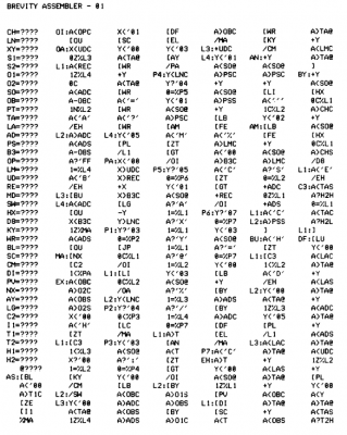

The book looks quite interesting, and is definitely one I wish I'd known about and had back in the early '80s. For those curious as to what BREVITY looks like, here's the first page (of three and a bit) of the BREVITY assembler listing.

Curt, thanks for the page. That's awfully cryptic. It's apparently actual source code. Is there an interpretation?

Well, perhaps no more cryptic than standard 6502 assembler mnemnonics are to the uninitiated.
Earlier chapters in the book explain the language and the whole chapter leading up to this explains how to write an assembler, so I presume that would be all you'd need to understand this source listing at the end of the chapter. The book's on my to-read list, so I may go do a writeup at some point after I get around to reading it.
In the meantime, I know that labels are no more than two letters, so clearly the `XX:` bits are labels, and I'd guess that `+Y` is INY and maybe `Y<'01` is LDY #1, A?'S' is CMP #'S, and the `1=` and `0=` bits are BEQ and BNE, or something along those lines. And I seem to recall seeing some punctuation prefixes for various addressing modes.

Yeah, at first glance it's actually kinda neat, I think. "Terse" is probably a better adjective than "cryptic". It even mentions comment and macro capabilities. The book is full of source examples for useful tasks.
@0200 means ORG $0200
/L3 means JMP L3
[PR means JSR PR
] means RTS
. means RTI
0C means CLC
-X means DEX
A<X means TXA
A<'00 means LDA #$00
A>C1X means STA C1,X
A>IN@ means STA (IN),Y
0=%L1 means BNE L1 (forward reference)

It should certainly be possible to hand-assemble the source code given... it might even be possible to rig up a quick and dirty nearly-assembler to deal with the source code given - it only needs to be nearly right, to assist in making a binary for this code, at which point it can assemble itself.
I think this would be a very nice resurrection project.
