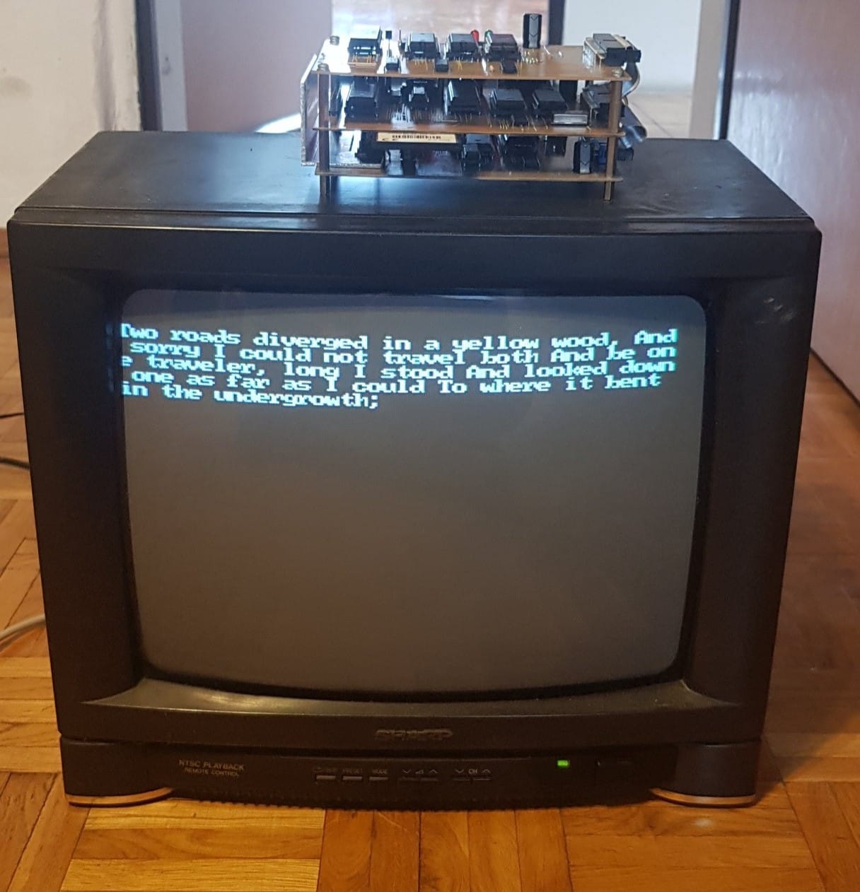

I returned to one of my old projects - homemade computer with 6502 and TMS9918 video controller.
Computer itself works with EhBasic, now I am going to write some code to add the TMS9918 support. I already done that with my other project utilizing 8080 CPU, so it is tested design. I also have 8080 code to base on. Unfortunately I came across some problems.
I was able to communicate with TMS9918 and initialize its registers. At this point I have garbage on screen, because VRAM wasn't initialized yet. I need to transfer character definitions stored in EPROM to VRAM.

Unfortunately code freezes when I try to call VDPWVRAM procedure. What Am I doing wrong?

The problem is that the JSR is pushing the return address, so that's going to be at the top of the stack when VDDWVRAM starts. And the RTS will be using the value pushed by the caller as the return address - which is not going to go well. The 6502 isn't great at manipulating the stack - if you need more parameters than will fit in memory (edit: I meant 'in registers', of course) it's more common to stick them in page 0, as you have with BLKIND and BLKLEN.
If you really want to use the stack, the cleanest is probably to use TSX; LDA $0103, X (I think it's $0103, but I've never used this method myself). Then the caller has to remove the data that it pushed.

As has been pointed out, at entry to the routine the stack state is not what the routine expects. There are a number of ways to deal with that. One approach:

Thanks. It works now. I suspected it must have been something trivial, I was unable to notice. ;)
