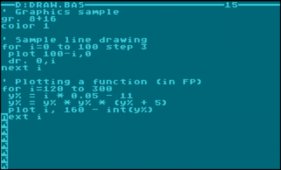

BASIC is simple for writing a compiler. See my https://github.com/dmsc/fastbasic , this compiles to a very simple VM. The language and compiler are designed to be fast and small on the 6502 - the full IDE with FP support is only 9.5KB, this includes graphics and sound commands and a full screen editor.
The problem with BASIC is the lack of data types, this means that the compiler should be a lot more complex if you want speed. In fastbasic all variables default to integer (16 bit signed), and you need to add a "%" to the variable names to specify floating point variables - this is inverse of other BASIC as my target is writing games that don't normally need floating point. The compiler tries to parse expressions as integer first and floating point if not possible, this means that "PRINT A/3 " gives a different result than "PRINT A/3.0", as the first one is evaluated as integer.
The screenshot shows a typical session in the integrated full-screen editor, you can see that the compiler also support abbreviations ("DR. instead of DRAWTO, GR. instead of GRAPHICS, etc.).
