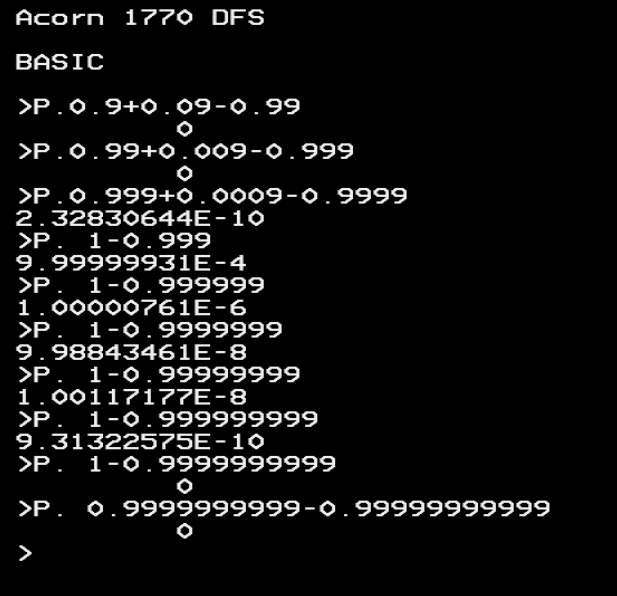

Note sure if this is any help, but I was musing about how many significant digits need to be accepted by a decimal to float input routine. And how things should be rounded. It feels like it might be valid to accumulate the mantissa at much higher precision than the eventual target precision.
Here's BBC Basic in action - not sure if these results are as you'd expect, but it might be food for thought.

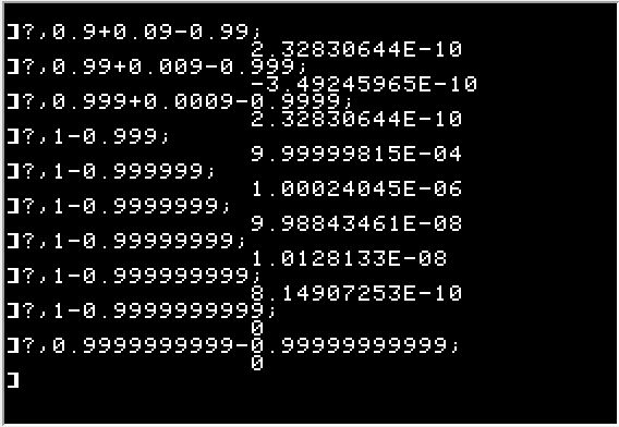

Here's how the Apple ][+ responds to your inputs using its MS 40-bit floats:
Similar, but not quite as "accurate" on average.
Here's how the TRS-80 Model III responds to the same inputs with its MS 32-bit floats:
There is an automatic promotion (including a brutal speed penalty) to MS 64-bit floats for longer input strings.
If I ever get to that point with Woz floats, I'll do the same experiment. In the meantime, what other kinds of inputs could you imagine that might shed some light on a few of the darker corner-cases?

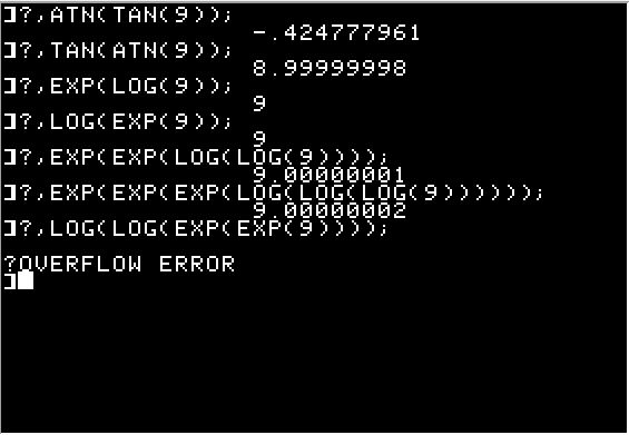

 Post subject: Re: Woz FP revisited
PostPosted: Fri Aug 30, 2019 6:42 am
Posts: 1949
AFAIK, none of the 8-bit MS BASICs included arcsin(), arccos() or degree mode, but I tried the following Apple ][+ experiment:

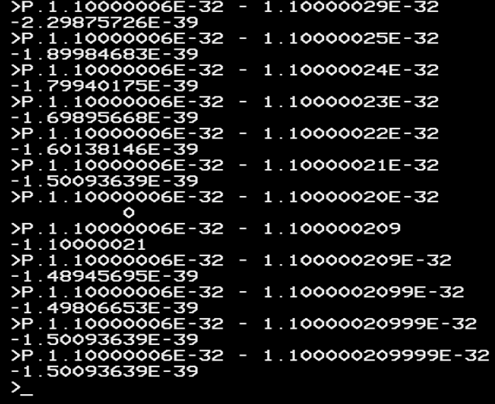

PostPosted: Fri Aug 30, 2019 6:49 am
I tried to find some references about this. I didn't quite find what I wanted, but I did find:
As explained in that final link, for a different question, round-trip tests are not quite what we're interested in here, but they might point to some interesting test cases.
Here's what BBC Basic did with a few tests:
