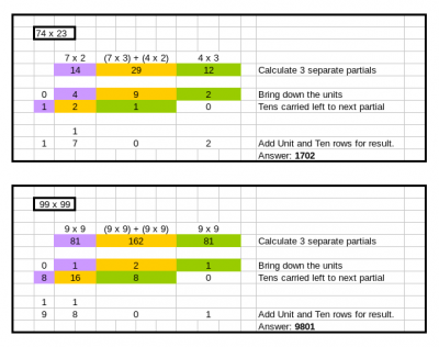

I was curious about the fastest way to do 8 bit packed BCD multiplication, so I tried it a few different ways to get the average cycles required. I ran all combinations from $00 x $00 to $99 x $99 in a loop in the simulator. For each one, I subtracted the loop overhead time from the total time and divided by 10,000 to get average cycles per calculation. Here are the results:
1. Repeated additions: 1,596
2. Repeated additions, smaller multiplicand in counter: 1,236.66
3. Shift/add: 300.8
4. 4x8 bit lookup table: 107
5. 4x8 bit lookup tables aligned to $x000: 103
6. Russian peasant algorithm: 274.02
7. Quarter squares with first half of table: 115.33
8. Quarter squares with whole table: 118
Code is below. Please let me know what I can improve or if you see any mistakes.

I started working on a test using the ūrdhva tiryagbhyāṃ Sūtra for multiplication, though ran into a 4bit shift issue of my own (too many).
I can probably expand the table to get around it.
Basically, the idea was to break the single 8x8 multiply into four 4x4 multiplies where the results can be fetched from a lookup table.
The table address consists of the high and low nyble to be multiplied with the data containing the result.
;     0    1    2    3    4    5    6    7    8    9  |---- Address  Padding ----|
.DB $00, $00, $00, $00, $00, $00, $00, $00, $00, $00, $FA, $FB, $FC, $FD, $FE, $FF	; x 0
.DB $00, $01, $02, $03, $04, $05, $06, $07, $08, $09, $FA, $FB, $FC, $FD, $FE, $FF	; x 1
.DB $00, $02, $04, $06, $08, $10, $12, $14, $16, $18, $FA, $FB, $FC, $FD, $FE, $FF	; x 2
.DB $00, $03, $06, $09, $12, $15, $18, $21, $24, $27, $FA, $FB, $FC, $FD, $FE, $FF	; x 3
.DB $00, $04, $08, $12, $16, $20, $24, $28, $32, $36, $FA, $FB, $FC, $FD, $FE, $FF	; x 4
.DB $00, $05, $10, $15, $20, $25, $30, $35, $40, $45, $FA, $FB, $FC, $FD, $FE, $FF	; x 5
.DB $00, $06, $12, $18, $24, $30, $36, $42, $48, $54, $FA, $FB, $FC, $FD, $FE, $FF	; x 6
.DB $00, $07, $14, $21, $28, $35, $42, $49, $56, $63, $FA, $FB, $FC, $FD, $FE, $FF	; x 7
.DB $00, $08, $16, $24, $32, $40, $48, $56, $64, $72, $FA, $FB, $FC, $FD, $FE, $FF	; x 8
.DB $00, $09, $18, $27, $36, $45, $54, $63, $72, $81, $FA, $FB, $FC, $FD, $FE, $FF	; x 9
I put together a couple of examples to help show the workings behind the math.
Urdhva Tiryagbhyam worked examples.

Oops, you're right, I do see now that the table indexing wouldn't work: $09+$09 is $12 in binary, but $18 in BCD, but you can also reach $12 with $10+$2 (in either sense) - so the table entry cannot correspond to a unique sum of BCD inputs.
I haven't had time to try it yet, but the fastest version might be to convert BCD to decimal with a lookup table and use that to index into a table of BCD values.

I wonder, would excess-3 notation be a better bet for this?
Hmm, I've never heard of this. The Wikipedia page says it was used in some calculators. So, I made a spreadsheet with $33 added to both operands but it still looks like there is overlap. Wouldn't adding $33 to both operands make it $66 greater than the BCD sum? Do you mean to add it as BCD or just a binary add? I tried all the combinations and there is still overlap.
Re: Fast BCD multiplication
Hmm, I thought it worked out neatly, but trying it out I seem to be confused.

Druzyek wrote:
I think you could convert BCD to binary and divide by two with one table look up and use a 200 byte table like you mentioned.
On second thought, you have to add 1 if a and b are both odd, since halving them leaves two halves (which your code does I think).
Edit: Also, how to do you handle one odd and one even input? Don't you need to subtract one, then add it back after the table look up? I was trying things out on paper and couldn't get it to work out for one even and one odd, then I found this: http://www.trottermath.net/algebra/multsqs.html
Edit 2: It looks like you can do it taking even and odd into account too: http://codebase64.org/doku.php?id=base: ... iplication
I guess you are right there. We lose 0.5 in instances were one of the original numbers were odd, so doing a LSR is not going to work.
In fact, one should skip the division by two of the original numbers and double the array (to 512 words) to get a correct lookup table (and take that into account that you are retrieving a value 4 times what you intended). After subtraction you simply divide by 4.
