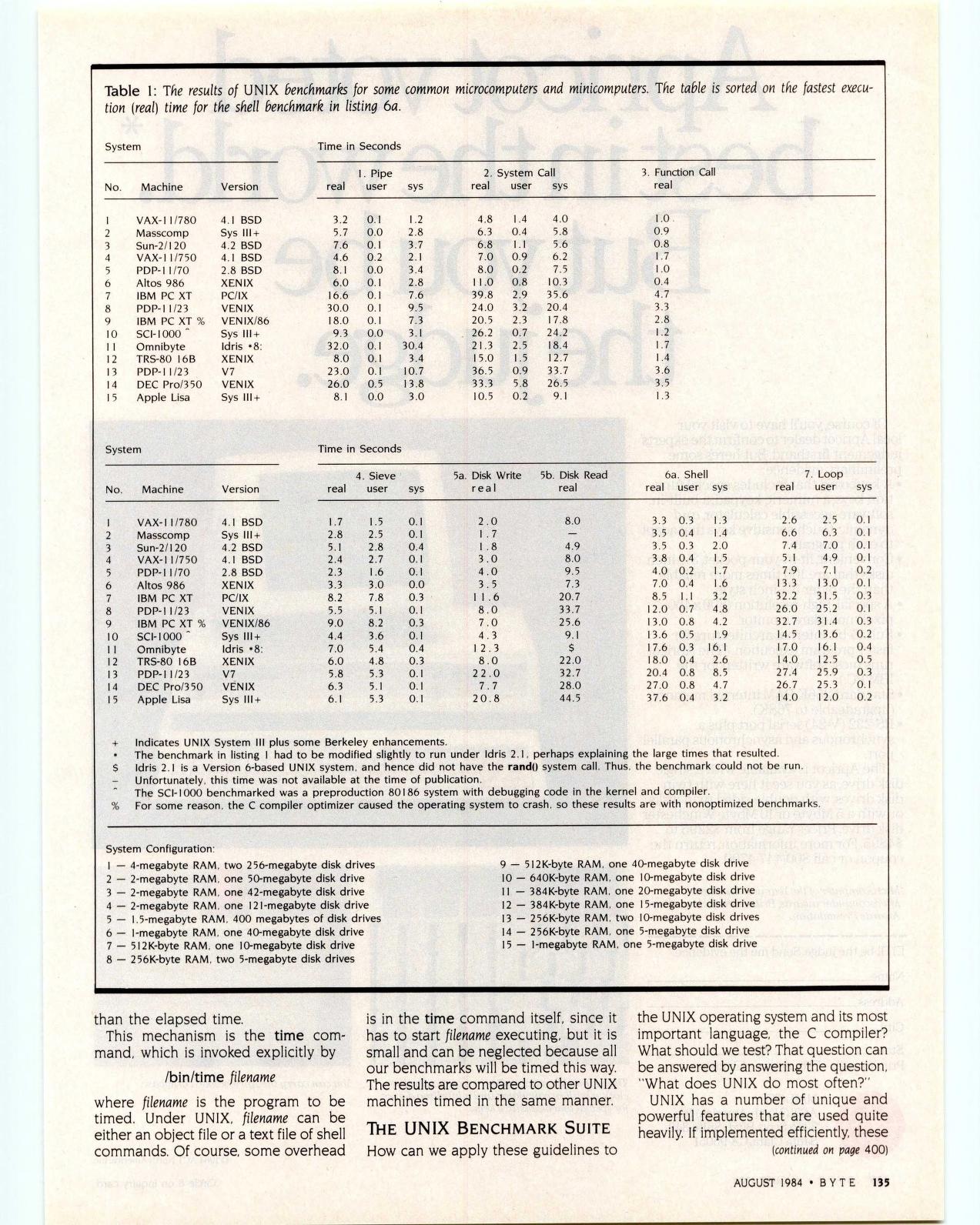

Benchmarking UNIX systems by David Hinnant
BYTE Aug 1984 p.132
Tabulation of results (incomplete, I think):
p301 from 1983-01
p140 from 1984-08
