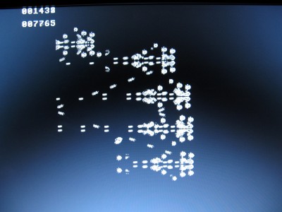

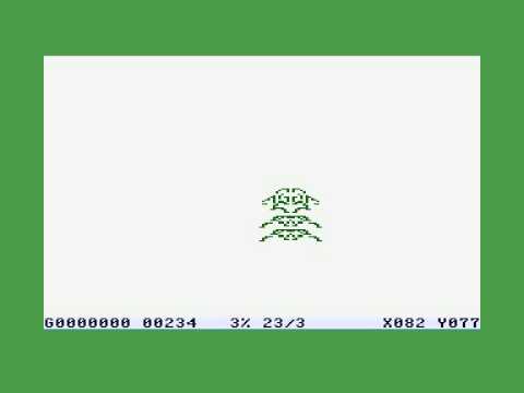

Here's a screen from Xlife-8:
Here's a screen from Life88:
Here's a video of some patterns running on these programs. Here's Xlife-8 running on a C64.

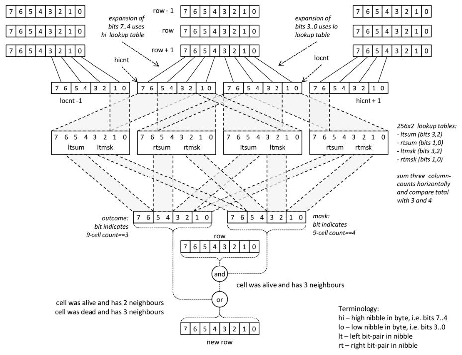

File comment: Data flow in Life88, drawn by DaveB

A couple of things stand out for me, having looked a bit more at the Life88 diagram
- the extreme benefit of using lookup tables to transform a byte into a byte (I think there are 7 page-sized lookup tables in the code)
- the clever avoidance of shifts, in marshalling the partial bytes into the appropriate collections, to deal with the overlapping windows

We now take well less than 200 cycles in computing the next generation of a 4x2 patch, but there's overhead in traversing the data structure so the average performance overall is 354 cycles per 4x2 operation. We could probably knock 50 cycles off that by moving from 4k to 32k table.

PostPosted: Wed Nov 23, 2016 4:40 pm
Arlet wrote:
On the FPGA-based 6502 boards, you could make a Game of Life accelerator ...
And this, of course, is an interesting idea! I do like the possibility of point accelerations. Sometimes, like a CRC or a multiply instruction, it's easy to see what to do and what the benefit is. I'm not quite sure what a Life accelerator would look like - any idea?
PostPosted: Wed Nov 23, 2016 5:02 pm
A simple idea would be to replace your lookup tables with a logic expression implemented in the FPGA, so you could do the same thing you're doing now, but without having to deal with huge tables.
PostPosted: Wed Nov 23, 2016 5:09 pm
Ah, of course - 24 bits in, 8 bits out, just a big mass of logic in between. But it's all quite simple stuff, so single clock cycle for sure.
Edit: even quicker if it's 32 bits in, 8 bits out!
PostPosted: Wed Nov 23, 2016 5:12 pm
Actually I'm almost tempted to consider a writeable control store approach, using distributed RAM to control a function generator which maps 32->8 bits and has enough generality to compute a Life algorithm. Like having an FPGA in your FPGA.
