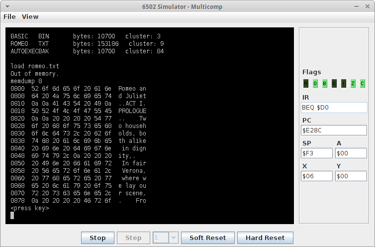

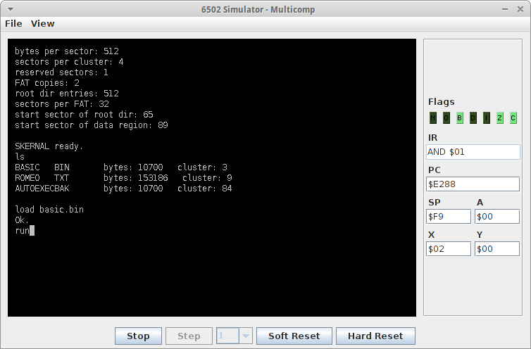

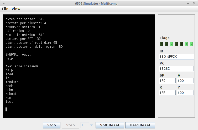

The main features are:
  • Rudimentary command line
  • Supports (and requires) the SD card controller on MULTICOMP
  • Basic support for the FAT16 file system (currently read-only, only 8.3 file names, only root directory)
  • List files in root directory of the FAT16 file system
  • Load files into memory (starting at page 8 until end of RAM or EOF)
  • Execute files loaded from SD card (JSR to the start of page eight)
  • Some facility to inspect and alter memory contents
  • Load and execute the file "autoexec.bin" on boot, if present
It's perhaps the last feature that's most useful. On MULTICOMP, the ROM is baked into the FPGA core, so changing the software basically means recompiling the whole computer. By flashing SKERNAL once and just updating autoexec.bin on the SD card one can have the machine boot into custom software without recompiling/reprogramming of the "hardware".

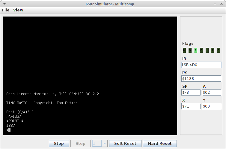

Here's TinyBasic loaded from FAT16 and executed:
