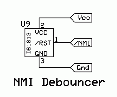

I've run into a bit of a snag with some NMI code for the SBC I've built (based on Daryl Rictor's board). I'm creating a programmer's "panic" button that returns code execution to the monitor program...the code will never return to where it was originally executing.
I connected one of the VIAs to /NMI, configured CA1 with a pull-up resistor and a push button switch to ground, and configured and armed the correct interrupt -- this is how Commodore did it for the RUN/STOP-RESTORE combination, although I'm using only one switch.
Here is the NMI handler code:

The above code works, returning to the monitor program, but only once -- the code to re-arm the interrupt is commented out. When this code is enabled, it never returns from the interrupt, requiring a hard reset. I'm sure it's something obvious to the experienced programmer, but I'm plain missing it. Maybe I should re-arm the interrupt in the monitor?
I did read the Interrupts tutorial and other than my interrupt disable and the method of re-arming the interrupt, the code is pretty simple.
Any nudge in the right direction would be appreciated. Thanks!

PostPosted: Tue Feb 18, 2014 2:09 am
RichCini wrote:
I connected one of the VIAs to /NMI, configured CA1 with a pull-up resistor and a push button switch to ground [...] The above code works, returning to the monitor program, but only once -- the code to re-arm the interrupt is commented out. When this code is enabled, it never returns from the interrupt, requiring a hard reset. I'm sure it's something obvious to the experienced programmer, but I'm plain missing it. Maybe I should re-arm the interrupt in the monitor? [...] Any nudge in the right direction would be appreciated. Thanks!
It sounds like you didn't de-bounce the switch. An RC followed by a Schmitt-trigger gate will do the job. Make it take 25-50ms to respond and send an active edge to CA1. Without the de-bouncing, you're probably entering the NMI ISR many, many times, possibly enough to overrun the stack.

PostPosted: Tue Feb 18, 2014 5:19 am
Posts: 8504
RichCini wrote:
All --
I connected one of the VIAs to /NMI, configured CA1 with a pull-up resistor and a push button switch to ground, and configured and armed the correct interrupt -- this is how Commodore did it for the RUN/STOP-RESTORE combination, although I'm using only one switch...
You're making it way too complicated. Hook up a Maxim DS1813 to /NMI, along with a push button between /NMI and ground (see attachment). When you press the push button and ground /NMI, the DS1813 will hold /NMI low for 150-200 milliseconds after you release the push button, thus debouncing the circuit. In your NMI handler, remove the beginning SEI, which as Garth pointed out, is redundant. Push the registers and enter your M/L monitor, making sure to re-enable IRQs at some point. Nothing else is needed.
What I have described is the exact setup I used in POC V1, which works like a charm. The Commodore method was necessary because /NMI is also used by the 6522 (6526 in the C-64 and C-128) to interrupt when the fake RS-232 handler needed attention. If your only use for /NMI is to regain control when a program goes berserk you don't need the extra stuff involved with the 6522.
File comment: NMI Debouncer
PostPosted: Tue Feb 18, 2014 1:06 pm
Joined: Wed Sep 03, 2003 6:53 pm
Posts: 153
Location: Long Island, NY
RichCini wrote:
All --
This is excellent! I'm actually using the 1813 for handling reset on the board (DS1813-10). I'll give this a try since I have a bunch of them, and there's space on the board for it.

BDD, a query about your use of a DS1813 as an NMI debouncer: I think it will cause an NMI at power-up time. Is that right, and does it need any particular attention?
PostPosted: Tue Feb 18, 2014 6:38 pm
Ed, it should be ok, as the rising edge is not an issue.
Strangely enough, no. Immediately after power-on, the other DS1813 that is attached to reset has the MPU halted, so the latter doesn't pay attention to NMI. Even if the reset DS1813 clears first, startup will proceed normally, since as Garth said, the MPU doesn't react to the rising edge on NMI when its DS1813 clears.
