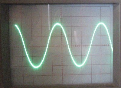

Just playing
This is meant to be the standard parabolic pseudo sine wave generator.
in the absolute minimum of code.
 clc
 ldy #$10
 lda #$7F
LOOP1
 dey
LOOP2
 sty temp
 adc temp
 bmi LOOP1
 iny
 jmp LOOP2
Re: minimum code pseudo sine wave
Good job! Here's what I got on the oscilloscope, having added only STA VIA2PA afer the ADC instruction to send the result to the D/A converter:
It would be even slightly better if I were to sync it to a timer interrupt, since as it is it's a couple more clocks for one half of the cycle than it is for the other (19 versus 17 with the variable not in ZP).
hmm
I get 15 and 13 cycles.
I guess if you were going to time it with code you'd have to add
a nop to the dey side.
Add 4 clocks for the STA VIA2PA (for the D/A converter).
About the NOP-- of course. I was in too big of a hurry. :oops:
