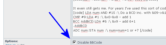

Edit: sorry, can't get the formatting to work. [Edited 4/1/13 by moderator to make it work, by unchecking the "Disable BBCode" box]
I was able to reproduce that problem by checking the "Disable BBCode" box. I don't know what BB code is, but I suggest you see what's in the box, and if it's checked then try un-checking it. :D
Ah ha! Thanks. On a hunch I went to the Member Settings and there's a "enable BB code" setting there to enable it by default.
