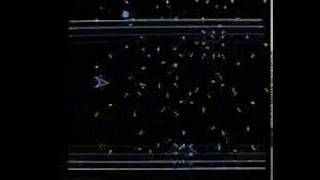

That Defendalike looks really good:
I think I was planning some kind of dual-ported RAM based cartridge so it could be reprogrammed from a Beeb. But that was many many years ago!

Yes it's great, very smooth too. You wouldnt think the Vectrex's screen would work well for Defender since it's quite narrow, but it's a very good game. Vector Pilot is also really good, that only came out last year.
