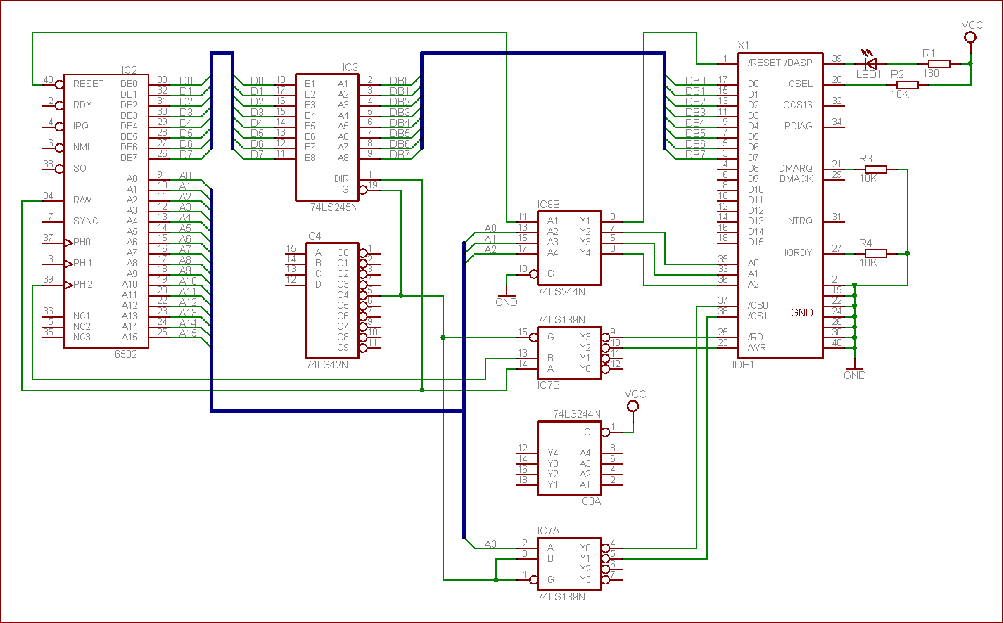

cjb wrote:
Although it does require 14 bits of digital I/O. .... it manages a "my god never seen that before" 14.5kB/sec reads.
May I point you to my 8-bit IDE interface for the 1541 drive? Just three IC's needed (with short lines just one) and a connector.
Regarding the speed, I never measured it because the drive <-> computer link was the bottleneck, not the IDE interface. But at least 50 KB/sec should be possible IMHO.
Because there is no bitbanging needed anymore, less instructions are needed (hence the higher speed). This would mean that your 4 KB of code could became smaller i.e. you have more room for other features.
