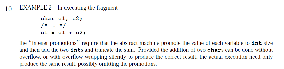

PostPosted: Thu Mar 23, 2023 6:26 pm
According to C standard, addition of smaller integer types should be promoted to 'int' before doing the addition, so there's no need to do a cast first.

PostPosted: Thu Mar 23, 2023 6:32 pm
Posts: 741
Ah OK, apologies, I had thought it just promoted to the wider width of the two.

PostPosted: Thu Mar 23, 2023 6:39 pm
It does that too, but only if one of the types is larger than 'int'. So if you do int + long, it will first promote the 'int' to 'long' and then do long+long addition.
