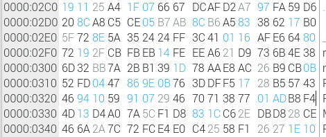

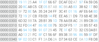

PostPosted: Thu Mar 23, 2023 5:10 pm
Joined: Mon Mar 13, 2023 9:38 pm
Posts: 80
I feel like there's a bug somewhere. I used my code in C (which is a literal translation of your 6502 code to C) and your code in C. I have the same output on both sides up to byte 326 and then it's different. My byte 326 is at $46 and yours is at $45. Do you know what could be the problem?
My C code :
Your C code:
And with your C code i've loops :
Found '008AA873' at index 0 !
Found '008AA873' at index 11EC9D07 !
Found '008AA873' at index 36982356 !
Found '008AA873' at index B20751BF !
But not with my C code.
