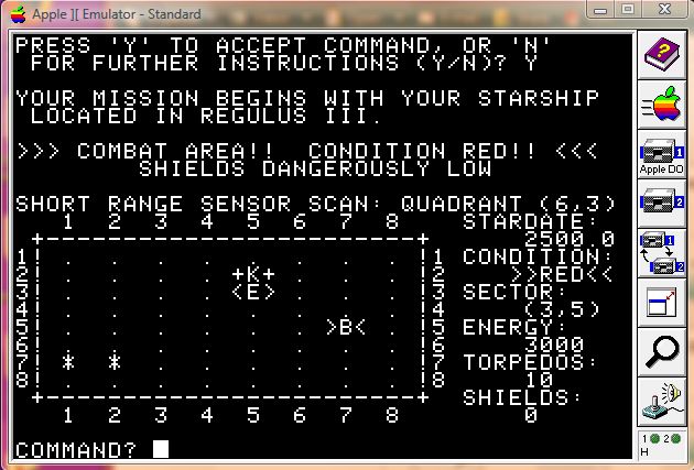

I finally got VTL02C up and ready for prime-time:
It's 1008 bytes in Apple ][ trim, and its execution speed is roughly equivalent to the original VTL02, using Klaus' 1000 prime spaghetti-fest (delicious, BTW, and very similar in coding style to the interpreter itself). When I crank AppleWin up to 2 MHz to normalize it with the recently reported times, it finds 1000 primes in 88 seconds. Replacing the output statements with dummy assignment statements reduces the time to 78 seconds.
vtl02ca2.asm [36.32 KiB]
Downloaded 431 times
Enjoy!
Mike B.

Klaus2m5 wrote:
... The line numbers representing a branch target could be marked up with a character $60-$7F (lowercase & some symbols). On startup of program mode an additional variable array will be populated with the physical memory address of the marked lines. Whenever a character $60-$7F is referenced in a #= statement the find: is substituted by simply copying the physical address. The variable {!} also needs to be changed. It may become necessary to be able to save {!} to the additional variable array ...
It will be interesting to see how well this works, in view of conditional branches and computed branches like the following in line 8910:
8893 )
8895 ) PRINT DEVICE NAME FROM Y
8900 .=!
8910 #=Y*20+8920
8920 ?="ENGINE CONTROL ... ";
8930 #=.
8940 ?="S. RANGE SENSORS . ";
8950 #=.
8960 ?="L. RANGE SENSORS . ";
8970 #=.
8980 ?="PHASER CONTROL ... ";
8990 #=.
9000 ?="PHOTON TORPEDOS .. ";
9010 #=.
9020 ?="DAMAGE CONTROL ... ";
9030 #=.
9040 ?="SHIELD CONTROL ... ";
9050 #=.
9060 ?="LIBRARY COMPUTER . ";
9070 #=.
Mike B.
