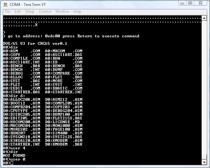

If you're interested in porting V3, I can probably save you some time ;-)
Thanks for the V3 software. As I read through Richard Leary's V3 documentation I realized all the changes are in CCM and PEM; there are no changes needed for SIM. So I extracted CCM and PEM from Leary's SYSGN302.ASM and appended my SIM for DOS/65 V2 and it all just worked!
Cool!
