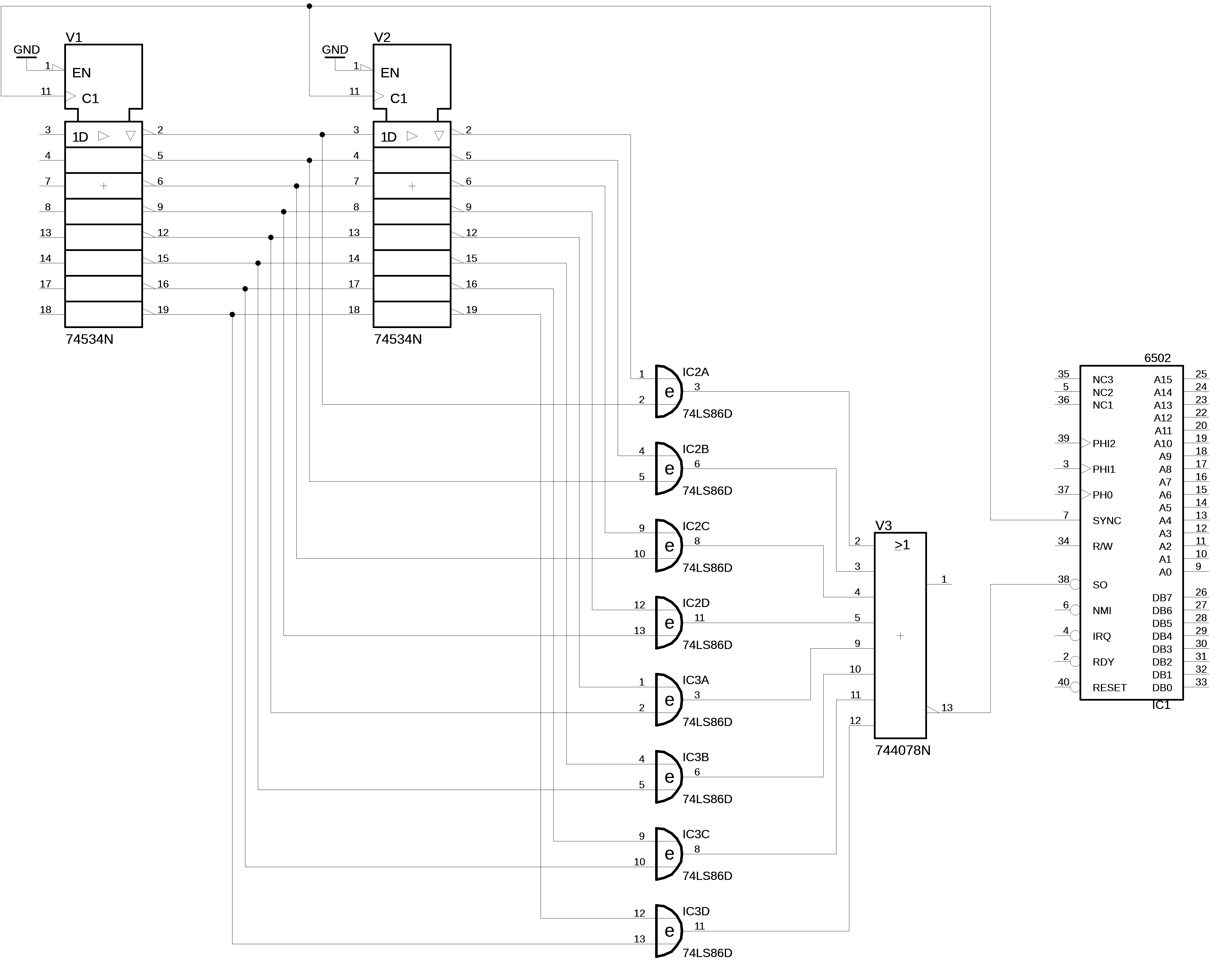

kakemoms wrote:
Alternately you can use two flip-flops (2-bit shift register) and a XOR per bit, then OR all the outputs and put them on the NMI/IRQ. That way you get an interrupt when one of the bits change.
Given the time delays of NMI/IRQ, and if you need this for every instance of I/O read (I was of the impression you wanted to look for bit changes as a trigger for reading the I/O data), you can connect the OR'ed input through a NOT to the SO pin and use overflow flag to trigger a read.
BVS *-2
LDA $IOREG
PostPosted: Fri Apr 03, 2020 11:03 pm
With a WDC 6502, you can use SEI : WAI, and then IRQ has no latency at all as it just resumes execution.
PostPosted: Sat Apr 04, 2020 4:51 am
Posts: 343
You can do WAI and IRQ, but I think it may require more cycles between each input than simply doing:
    LDX   #0
t   BVC   t
    LDA   $REG
    STA   $mem,X
    INX
    BNE   t
The circuit may look something like this: (sorry about the part numbers)
Obviously this is not going to work since the SYNC will trigger at each instruction (but it would work if you only wanted to look for activity with BVC).
I then though that you may use one of the address pins as flip-flip trigger (instead of SYNC), but since the loop is 10 or 11 bytes long, that would require a trigger each 16'th byte which means that one could use the A4 output and insert some extra NOP's.
As a last option, you could do the input storage as a direct memory storage thing by using address lines as memory address (without A0), input lines as data to that storage memory, and only have the code:
BVC  *-2
repeating indefinitely or for as long as the input would require it to..
PostPosted: Sat Apr 04, 2020 5:05 am
BVC takes 3 cycles on a taken branch. WAI takes 3 cycles to set up, then resumes normal execution as soon as an IRQ arrives. With I set, the interrupt handler is not entered and the usual overhead does not exist. So the performance is at worst similar, and you don't have to give up having a reliable V flag for arithmetic.
Thinking about it, the sync pulse would not be active if you use the WAI... so the flip-flops would not be transmitting and no IRQ signal would reach the mpu. It may work off the clock, but the IRQ would only trigger for one clock. Maybe its enough?
PostPosted: Tue Apr 07, 2020 6:13 am
I believe /NMI is edge sensitive, but /IRQ is not - normally it would be sampled on a SYNC cycle. I think a single full cycle of IRQ is enough to wake up from WAI, though.
