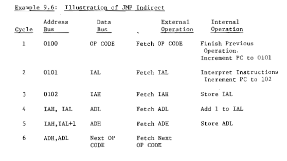

So, did MOS document this bug/feature in their original datasheet/documentation of their processor? If yes, it's a feature, if no, it's a bug. I think the ROL bug there was in older 6502s is clearly defined to as a "bug", because it was an actual mistake in the processor and was never intended to be there. If JMP () warp-around is the same, then it's a bug. But if it is clearly stated that JMP () will warp-around in the manufacturer documentation, it's a feature.
JMP (<addr>) itself is not defective. It becomes defective in the NMOS parts if the jump vector address (<addr>) straddles a page boundary.
What's even the point to replying me and state the obvious? Of course I say "jmp () warp-arround" to make it shorter than saying "jmp () warp-arround when the lower byte is $ff" in order to keep my point short and concise. My efforts to do so are now ruined, thank you.

Good idea. I checked the datasheets (MOS, Rockwell) for their description what they call Absolute Indexed addressing. They say that the final byte fetched is the next byte - no mention of page wraparound or of pages, unlike their descriptions of the other modes. So this is confirmation that JMP (abs,x) was always intended to work the way it eventually did work, on the C02 parts.

In the MOS document you linked to, page 6 under "Absolute indirect" (and NOT absolute indexed !) it says :
The next memory location contains the high order byte of the effective address which is loaded into the sixteen bits of the program counter.
This makes it very clear it is not supposed to warp around, and if this document is considered as a reference, the jmp () warp-around is a bug. Now the question is whether it is acceptable to use these as an original 6502 reference.
I'll also add that warp-around within zero-page addressing is clearly documented, since it's mentioned that it always address page zero. So nobody should expect e.g. lda $ff,X to load from page one if X is nonzero and the ZP variant of the instruction is used.
I think we may be in violent agreement!

PostPosted: Sat Aug 20, 2016 4:21 pm
On the other hand, the MOS MCS6500 Microcomputer Family Programming Manual (January 1976) contains a cycle description (page 141) that shows the wrap around as documented:
PostPosted: Sat Aug 20, 2016 4:45 pm
Arlet wrote:
the MOS MCS6500 Microcomputer Family Programming Manual (January 1976) [...] shows the wrap around as documented:
And yet, section 9.8.1 (page 141) of the same manual documents the opposite.
    "In the JMP Indirect instruction, the second and third bytes of the instruction represent the indirect low and high bytes respectively of the memory location containing ADL. Once ADL is fetched, the program counter is incremented with the next location containing ADH."
PostPosted: Sat Aug 20, 2016 4:49 pm
Yes, many datasheets are either wrong or inconsistent - and therefore wrong! I'd take the table that Arlet notes as an extremely subtle admission of the bug! It seems pretty unwise to try to document internal operations in such a detailed fashion. Even if everything is correct, it makes it harder to make subsequent improvements. Having undocumented behaviour can be a feature.
I think everyone here who's spoken up, with the exception of litwr himself, regards that wrap-around as a bug. (But I'm not sure if it's even interesting to keep arguing about what we call something. Much more interesting to talk about how things work and how to program them.)
