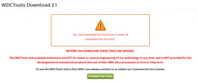

But... If someone can put together a rock-solid tutorial on the WDC C compiler to run under Linux from a Makefile, then I'll certainly take a look.
For me the other missing link is not just running the compiler but obtaining it as well. I've been pretty spoiled by projects and frameworks which include bash scripts to check for and install all the needed tooling. It's particularly helpful in modern workflows that involve developing on some disposable remote virtual instance, or simply to make it easier to teach others how to write for your platform. Pretty much everywhere I've worked encouraged writing/maintaining such scripts to speed onboarding and make equipment upgrades less of a headache.
This makes having to go to WDC's website, give them your email address, and wait to receive a *limited-use download link* really unappealing.
File comment: They've gone to a lot of trouble to keep people from actually using these tools :P

Well... They ask you not to disassemble the binaries, and not use them for commercial products that would run 65xx code in a chip provided by anyone else apart WDC themselves.
I can see that as a fair petition.
