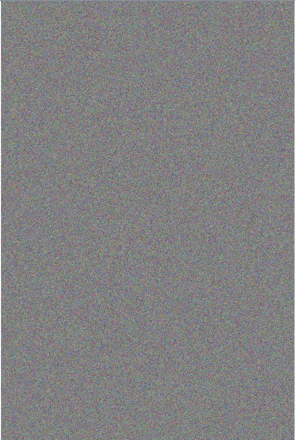

Hi all. I take this opportunity to post you the code I did in 1988 because it may interest someone.
It generates a random sequence of 2^32-1 bits (4.3 billion bits). It's a 32-bit GALOIS LFSR. Each call to the routine generates an 8-bit byte. We can therefore obtain (2^32)/8 bytes before repeating the sequence. There is no short cycle for all seed values.
//          Pukall LFSR 32

First a 4-byte seed must be put at seed:
The seed can vary from 1 to $FFFFFFFF but never 0 otherwise the LFSR produces only bits to 0.
Each call to the start: function returns a pseudorandom byte in rndbyte:
To mix the LFSR it is recommended to do 4 calls to the start: function before using the generated bytes in rndbyte:.
Not 4 calls to the start: function for each generated byte (rndbyte:) but only the first time. Then the generated bytes (rndbyte:) can be use directly.
The test vector is :
For a seed = $FFFFFFFF
the first 50 bytes are :
F1 64 75 CB 0B A0 29 DD 2E E5 E6 A9 2B 5C 40 A6 1E F0 55 DF 52 70 B3 DA 60 32 27 94 B1 2E 1C 3B 5E 8B 21 92 26 77 5A A9 B3 A2 BB 7F 93 E2 45 9A FE F9
A search on the integer space shows that there is no repetition of the sequence of the first 20 bytes for the example seed $FFFFFFFF:
Found 'F16475CBBA029DD2EE5E6A92B5C40A61EF055DF' at index 0 !
A FIPS 140-2 test shows that bytes are seen as random:

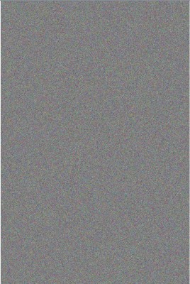

Some people use a picture to test randomness but it's not reliable, only FIPS 140-2 tests are reliable :
