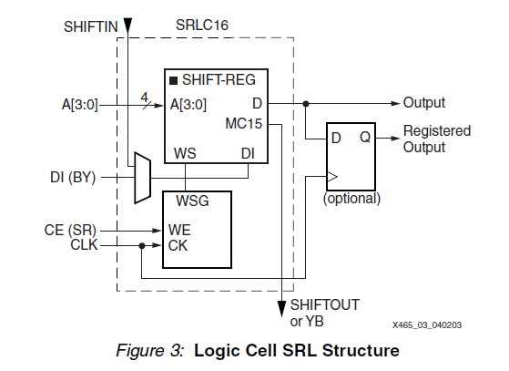

On Xilinx, you can configure a LUT as an SRL16 shift register. The cool trick is that you get 4 address lines that allow you to pick any of the 16 bits as output, but you also get a shift register that you can use to dynamically alter the table.
It's almost like a dynamically programmable LUT, but unfortunately for this application, you don't get access to the carry chain.
Edit: and of course, you also don't get to dynamically update the routing between various LUTs.
That's rather interesting - so we could reprogram a patch of the FPGA by serial shifting. We could presumably architect in some muxes which drive some adder or multiply resources if we wished.
For Life, we're only counting up to 3 or 4 (or 8 or 9, depending on how we do it) so a fast carry shouldn't be needed. But making this a general piece of reprogrammable fabric has an attraction.
(And of course, the serial shifting could be done automatically, taking inputs from byte-wide input registers, for easier programming by the host micro.)
