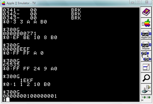

I have been playing around with some 8-bit ideas to settle my brain among the daily chaos, and recently arrived at this little ditty, in the key of NMOS:

It's a subroutine that tests a few ideas about parameter passing and return stack trickery, with the added bonus that it prints any unsigned 16-bit integer to stdout in any even base from 2 to 36, with optional minimum field width and pad character parameters. Here's a peek at some example runs:
It is no speed demon, but packs all of this general-purpose functionality into only 57 bytes. I tried to provide adequate comments, but I can answer any questions you might have about the details. Critiques and suggestions for further optimization are also most welcome.
