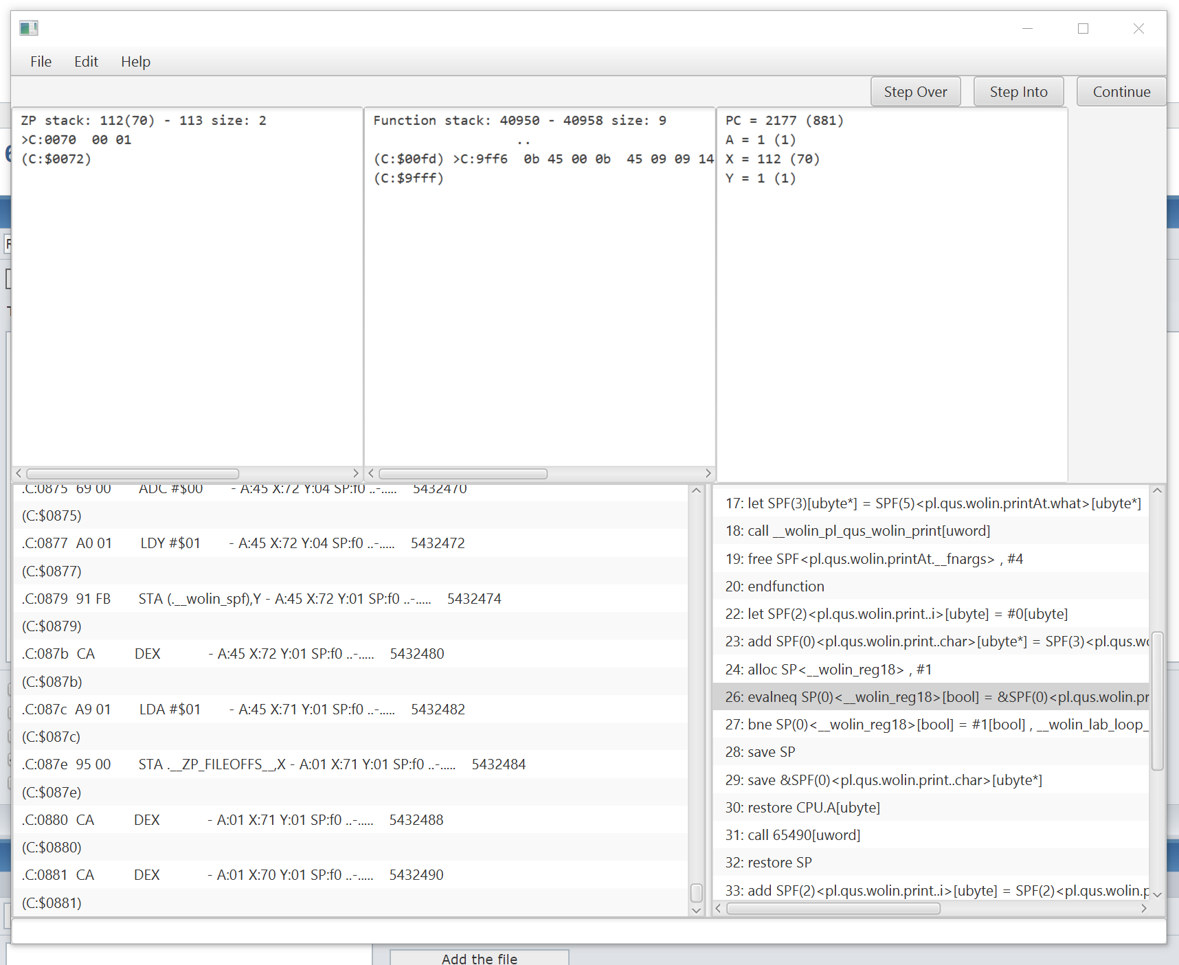

PostPosted: Sun Apr 19, 2020 5:05 pm
Joined: Sat Apr 20, 2019 5:31 pm
Posts: 104
Heh, I'm not using hardware stack besides for kernal function calls magic.
Anyway, here's something cool. Debugger for Wolin.
Upper pane:
Zero page stack dump
Function/locals stack dump
Register and CPU flags dump
Lower pane:
current CPU instruction
pseudo-asm source line of current CPU instruction (highlighted)
Now I can debug Wolin apps without cursing constantly.

There are two stacks (three if you count exception stack) used by Wolin, hardware stack is used just by JSRs (and some magic to pass kernal function parameters that sometimes use X register which is Wolin stack pointer)
The above sequence is hardcoded in templates, because if I used temporary ZP register in my pesud-asm it would be eaten by the optimizer as redundant reg, that's the problem!
ZPREG = something
other = ZPREG
gives
other = something
So... Unless I somehow tell optimizer not to get rid of ZP registers that contain pointers this won't work.
And as a quick recap:
"SP" is ZP stack (with X as SP) is used as operational stack, literaly a big array of CPU registers
"SPF" is function call + function locals stack, with ZP pointer as stack pointer
"SPE" is exception stack, also with ZP pointer
And thanks to my debugger now this code works (on C64):
package pl.qus.wolin
fun chrout^0xFFD2(char: ubyte^CPU.A)
fun plot^0xFFF0(x: ubyte^CPU.X, y: ubyte^CPU.Y)
var carry: bool^CPU.C
fun printAt(x: ubyte, y: ubyte, what: string) {
    carry = false
    plot(x,y)
    print(what)
fun print(what: string) {
    val i = 0
    val char = what[i]
    while (char != 0) {
        chrout(char)
        i++
        char = what[i]
fun main() {
    printAt(20,20,"dupa")
PostPosted: Mon Apr 20, 2020 4:36 pm

qus wrote:
resman wrote:
My first thought on this was "you have three stacks in play?" A function frame/stack, a zero page stack, and the hardware stack? I didn't read every post to understand your design trade-offs, but perhaps you could minimize or remove which stack does what.
Also, is the above sequence the result of the optimizer, or is it a common sequence you hand coded? In that case, a temporary ZP word could be used for pointer dereferencing.
Okay. Using the hardware stack in your example kind of confused the issue.
ZPREG = something
other = ZPREG
gives
other = something
But this shouldn't be what the optimizer is seeing. Using () to denote indirection, it should look like:
ZPREG = something
other = (ZPREG)
gives
other = (something)
Doing indirection through a local variable on SPF should be handled through ZPREG in your hand coded template, or somehow telling the code generator that you have to use a register on SP for indirection and not optimize it out. As an aside, the 65816 *can* do indirection through a stack variable. IMHO, the single most useful addressing mode of the 65816 for supporting HLLs.
    carry = false
    plot(x,y)
    print(what)
    val i = 0
    val char = what[i]
    while (char != 0) {
        chrout(char)
        i++
        char = what[i]
fun main() {
Nice to have a debugger. I really need to do something in PLASMA to make debugging easier.
PostPosted: Mon Apr 20, 2020 5:34 pm
Posts: 104
Thanks for your insights - yes, the optimizer code is a real mess, especialy pointer/reference substitution is rather... chaotic and probably wrong and will kick me in the face some day, but it works... for now.
Reading your PLASMA docs I guess I could learn a lot from you, so when you have time I would probably have some questions to ask!
