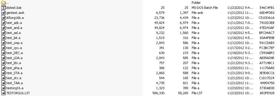

As I have never used your HXA assembler, can you explain some files present in the .zip you posted and how to use them in conjunction with HXA?
I took a snapshot for anyone else interested...
PostPosted: Tue Nov 27, 2012 2:36 am
Posts: 411
Location: Minnesota
dotest.bat - just a batch file to save some typing. Executes HXA_TW with TESTORG16.A as the file to assemble
gentest.awk - a quick-and-dirty AWK program to generate test files, generally one particular family at a time. I wasn't about to try to write 2700+ variants of ADC by hand and it was simple enough to hack it to produce most of the other tests (all the ones over 1K, anyway - the others were short enough to do by hand). It's by no means a polished effort.
i65org16b.a - implements all 65Org16b instructions using nested macros. The top-level "mnemonics" are all capitalized and in alphabetical order. The nested macros have names that embed a number (eg., "_3_") which reflects their nesting level (so I could keep them straight. Also they come out nicely in the listing). There are a couple that start "_9_", not because they're that deep but because they're called from so many different levels it seemed the easiest way to make sure every caller is at a higher level. They're also a bit different in that their definitions themselves are nested.
test_*.a - test files, usually one particular family each (the name is supposed to be a clue which one), usually created by
GENTEST.AWK. I didn't test instructions that amount to just one BYTE (eg, CLC, PHX), only ones that required some degree of argument examination to make sure the logic worked properly.
testorg16.a - a test harness, I65ORG16B.A and one or more TEST_*.A files are included by it for assembly. A modular approach so I could deal just with whatever family I was working on without having to worry about extraneous output.
testorg16.lst - the output of TESTORG16.A when all TEST_*.A test files are included in one assembly run
You can look at I65ORG16B.A to see what the macros are and TESTORG16.LST to see what they produce.

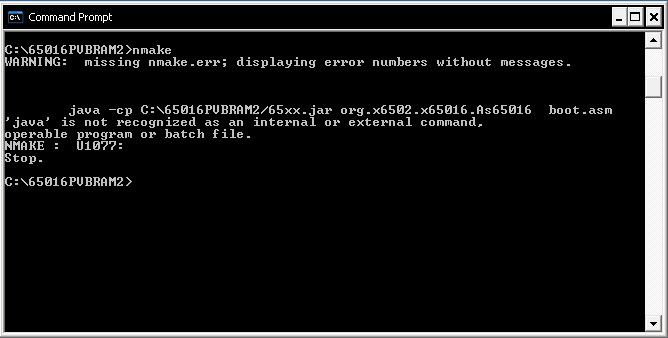

A question for Bitwise:
Yesterday I started receiving an error when trying to run NMAKE through no fault of my own. Any clues on what I can do to fix this problem?
I'm using Version 7 update 51 of Java.
EDIT: I should have googled first, sorry. Since I couldn't delete this post I figured I should complete the post. It's weird because this all of a sudden started happening last night for no good reason...
I found the answer on wiki.answers, followed the directions (similar to XP) and it's working again:
How do you stop the error 'java' is not recognized as an internal or external command operable program or batch file?
In: MS-DOS, Windows 7   [Edit categories]
Answer:
If you are getting that error, it means that either Java is not installed, or is not in your path.
If Java is not installed, go to http://www.java.com to install the most recent version of the JRE.
If you're sure you have already installed Java ensure the Java executable is in your system's path. You can do this by first finding the directory it is installed in. For example, mine is installed in C:\Program Files\Java\jre6. The executables are located in the bin directory.
In order to set your path (Assuming Windows Vista), go to Start -> Control Panel -> System, then click on the 'Advanced System Settings' link on the left, then the 'Environment Variables' button. In the lower section (Labeled 'System Variables'), scroll through and find the item labeled 'Path' and double click it. In the field labeled 'Variable value' go to the end and add a semicolon (;), and then the path your installation of Java is located. Using the example I gave above, I would have added ;C:\Program Files\Java\jre6\bin to the end of the line.
The procedure for 64-bit Windows Vista or Windows 7 is the same, except the text you will add to the Path variable is ";C:\Program Files (x86)\Java\jre6\bin". Notice there is still a semi-colon at the beginning of the line.
Once you have done this, you will need to close and reopen the command prompt if it is already open, and you should be able to run java without getting this error message.
