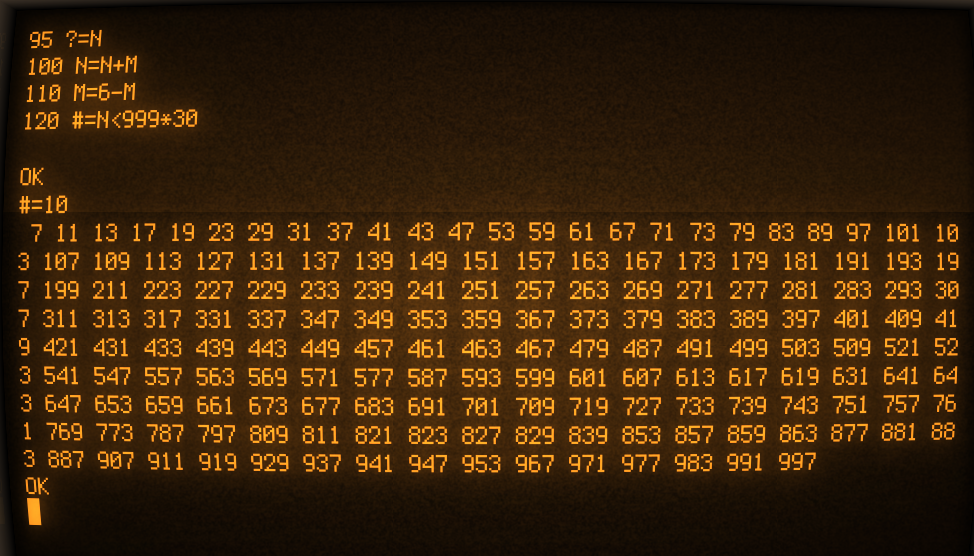

Good news! I just got VTL02 (Mike's version C) working on Daryl's SBC-4 (10MHz W65C816).
I am somewhat surprised that the prime-number shootout code ran in just over 3 seconds.
Thank you, Mike!
