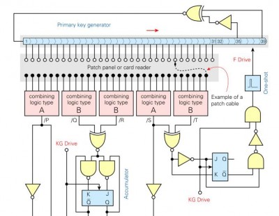

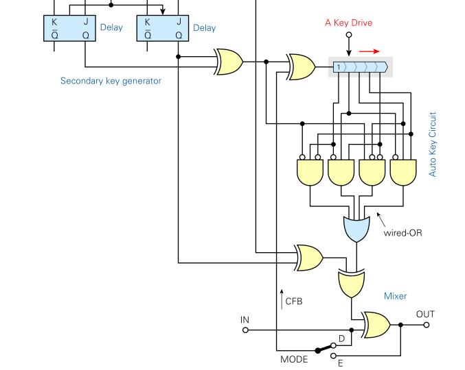

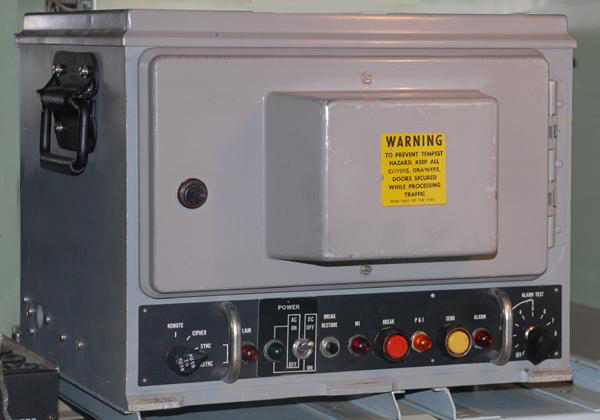

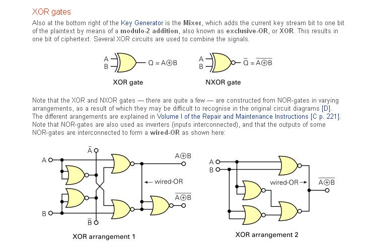

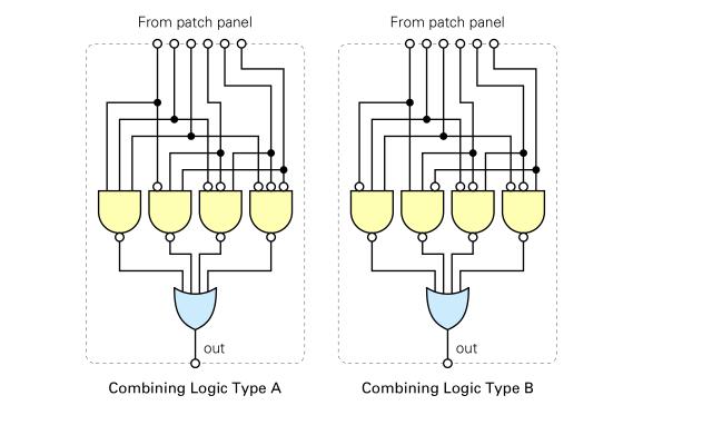

A single LFSR can be totally random and cryptographically secure if we add logic gates to make it nonlinear and this is only possible precisely because there is no pattern in the LFSR.
For example the US KW-7 encryption device used only 1 LFSR (39-bit LFSR) :

It is not the same. As can be seen in the design of the KW7, logic gates make the output bits of the LFSR non-linear but they never modify the content of the LFSR itself, which always behaves like an LFSR. The output bits of the LFSR after passing through the logic gates only modifies the progress of the LFSR (advance one step or not advance).
In the case of your algorithm, logic gates change the internal state of the algorithm, making its behavior mathematically unpredictable.
