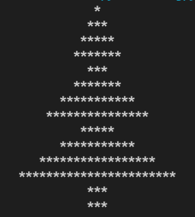

The challenge, then, is to produce exactly this output:

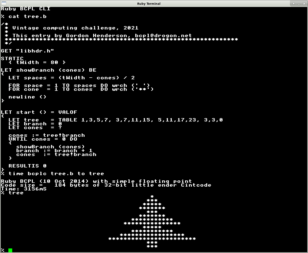

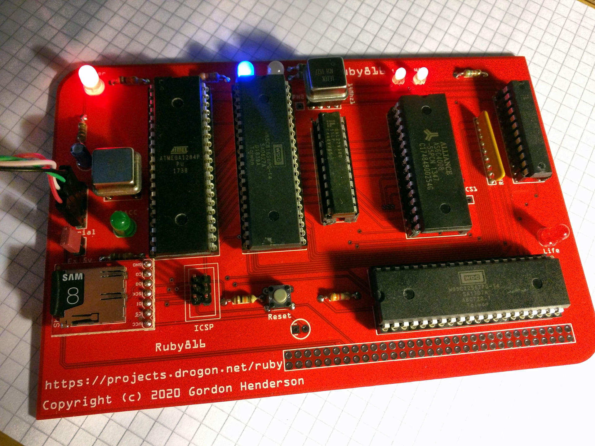

A good simple challenge - I've entered ... in BCPL on my Ruby '816, of-course ;-)
