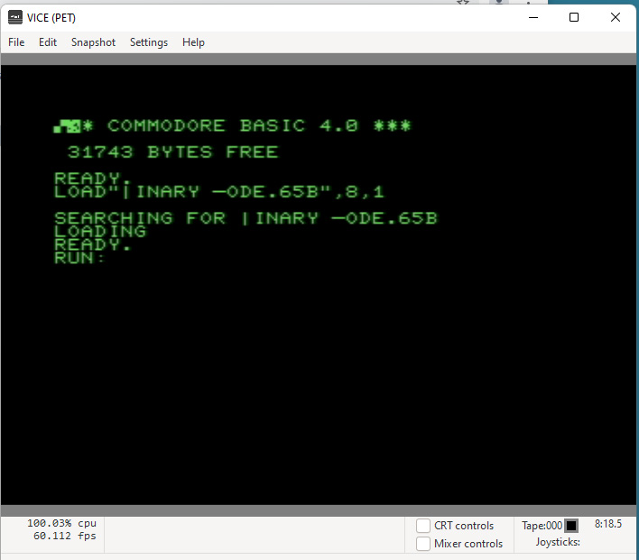

If there are any PET gurus out there, I would appreciate some ideas on why I can't seem to read input directly from PORTB on the 6520 that is connected to the PET keyboard. I am familiar enough with the hardware to know that bits (3:0) feed a 74LS145 BCD decoder that drives one of ten ROW lines LOW. I also know that pressing a key will drive one of the Columns LOW that feeds into the 6520 PORTB input.
I need to read input data from PORTB of the 6520 as fast as possible (for reasons I will explain later), so I made this basic assembly test just to make sure I was on the right track. I fully expected this to show characters change on the screen as I pressed various keys....

Simple enough, it sets the 145 to zero, then writes whatever value it finds on the input of PORTB to the upper left corner of the screen. Just to verify my sanity (and that the code works), it also dumps a rolling character to the second location on the screen, and that indeed works.
What is odd is that the keyboard has no effect on the first character, it just stays at 255. Even if I alter the 145 value, nothing changes.
I have run this code on 2 real PETs as well as vice, and it is the same on all.
Any ideas? I am almost certain that my addresses are correct; $E819 to set the 145, and $E812 to read the data.
On a side note, this "Basic Stub" just stuffs "SYS 2000" into basic line zero. Address 2000 is the start of assembly code.
I use this for all my PET progs, and it works well.
Here is a Vice shot, showing the 255 character (top left) and my rolling character working...
Cheers!

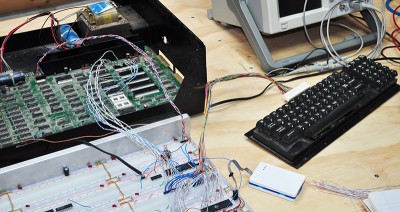

I should probably explain my goals here.
I have a connection between the PET keyboard port and something I am working on. I am, able to read PET keystrokes and even send PET keystrokes, which is required for my project. All good so far.
What I also want to do is have the PET read data being sent as fast as possible from this external device. This is the reason for wiring this PIA input capture program. What it will do is stream bytes read from the PIA into the PET's program memory starting at location 1025. So yeah... it will load programs into the PET just like the IEEE port does, but using the keyboard port instead.
So you may wonder... how does this strange little BootLoader get into memory in the first place? Well, it is poked into the cassette buffer at location 632 by the external device that temporarily hijacks the keyboard through the port. And yup, this part actually works already! The AVR covertly listens to the 74LS154 lines and then stuffs data into the VIA, simulating lightning fast input from the keyboard. It can poke the tiny bootloader into RAM in a few seconds. Once done, the command "SYS 634" is issued and then I want the PET to hurl bytes into RAM from the PIA.
Loading performance will be even faster than anything possible on the IEEE port. I expect to get at least 60 kilobytes per second!
But if I am a slave to the kernal, then I can only read bytes at 60 hertz, so that kills the entire idea dead.
In that case, I will have to go back to a plug in the option ROM socket and run my transfer from there.
I have to tap the keyboard plug anyhow, so I figure this would greatly reduce my wire count.
The only thing I can't solve is how to directly read data on the PIA PORTB, which I thought would be the easiest part of this experiment!
Oh, I am using VICE for the code tests, so I know I am not being beat by some hardware bug.
Here is my hardware rig so far...
The other ICs on the board are converting the video to the 1702 monitor. I will post this project in more detail when it gets off the ground, but here is the core idea...
https://www.youtube.com/watch?v=irBI9fVE9dY
