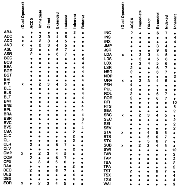

That is why we see the exclusive use of three-character mnemonics, unlike the ancestral 6800 language.
No. The 6800 assembly language as defined by Motorola uses exclusively three-character mnemonics. (See attached chart from the Motorola M6800 Programming Reference Manual.) Perhaps you have chosen to use some non-standard version of 6800 assembly.
(For what it's worth, I think that there's absolutely nothing wrong with being non-standard in any way in an assembly language you're defining, so long as you have a good reason for it. To make your language worse and more difficult to program in merely to follow a "standard" is blind stupidity. Do not take this to mean that I think every change out there is justified.)
PostPosted: Wed Sep 01, 2021 4:17 am
Posts: 8505
The 6800 assembly language does not exclusively use three-character mnemonics because accumulator-based instructions have a fourth mnemonic character identifying which accumulator is the target. For example, LDA #<operand> implicitly loads the 6502's (only) accumulator. The equivalent operation in 6800 assembly language would LDAA #<operand> or LDA A #<operand> in some assemblers (when I learned 6800 assembly language it was the former style). Loading the 6800's B-accumulator would be LDAB #<operand> or LDA B #<operand>. In both examples, 'A' and 'B' are considered to be part of the complete mnemonic, since they specify which accumulator is being loaded. This same pattern prevails for all of the 6800's accumulator-based instructions, e.g., STAA (store A-accumulator) or STAB (store B-accumulator).
See page 3-22 of Lance Leventhal's 6800 Assembly Language Programming for a reference.
PostPosted: Wed Sep 01, 2021 6:48 am
Posts: 730
Location: Tokyo, Japan
No. That character is not part of the mnemonic, it is part of the operand. E.g., `LDA B,#13`. Note where the space separating the mnemonic and the operand field is.
In both examples, 'A' and 'B' are considered to be part of the complete mnemonic...
By you, sure. But not by Motorola, which you'll note refers to them as "(Dual Operand)" in the excerpt I posted.
If you're going to go to battle for letters in the operand field being part of the mnemonic when they change the opcode or destination of other parts of the operand, keep in mind that in 6502 assembler, the `,X` in `LDA $(13,X)` does the same.
...in 6800 assembly language would LDAA #<operand>...
In whatever non-standard assembler you were using, sure. You won't see anything like that in Motorola's M6800 Programming Reference Manual.
Sure he differs from Motorola here. But I'm not buying that Motorola themselves created and published "non-standard mnemonics at the start" and it was only that later that third parties developed the "standard" mnemonics for the CPU. If you go down that route, who's to say that the mnemonics you so like for the 6502 are "standard"?
When you posted your reply here you already had a reference from me for Motorola's original programming manual for the 6800, which is freely available on archive.org. I suggest you go have a read. And maybe think about exactly why you're not explaining why that source is inconsistent with your third-party source and how that affects your argument, since you knew (or should have known) about that inconsistency.

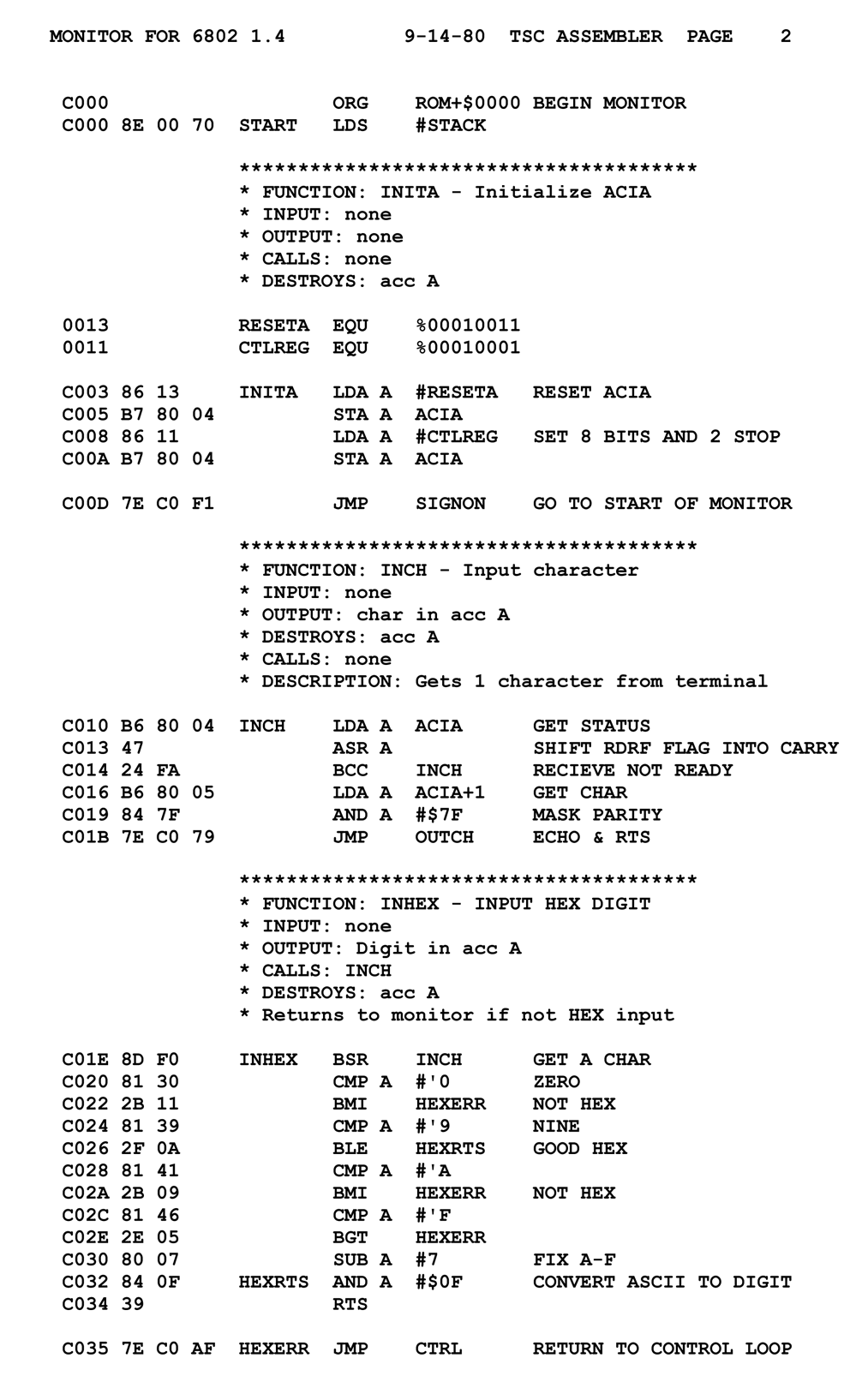

PostPosted: Wed Sep 01, 2021 7:07 am
Perhaps a little O.T.: I have no 6800 experience, but all the 6800 code I've seen put the A or B on the end of the mnemonic, with no space, making it four letters, as in BillG's post at viewtopic.php?p=78469#p78469 and all the subsequent posts in that topic ("6502 vs 6800")
PostPosted: Wed Sep 01, 2021 7:51 am
Posts: 704
Location: North Tejas
I thought I felt my ears burning...
I have been programming the 6800 since 1979. Though early Motorola documents showed the "split" instruction format, every assembler I have used allowed the alternative "merged" form as well.
Code listings in literature were about half and half. I never liked the split format. In those days of slow and small storage devices, that added space was wasteful.
It is insightful that the split format was deprecated in documentation for the 6809 and more notably, the 6801/6803 which sported some extensions of the original instruction set but was otherwise source and binary compatible.
https://www.lucidtechnologies.info/6803_instr.pdf
PostPosted: Wed Sep 01, 2021 7:53 am
Posts: 8505
Lance Leventhal shows both forms in his book, e.g., LDAA and LDA A. When I learned MC6800 assembly language in 1975, the crossassembler I was using (running on an IBM S360 mainframe) only recognized the xxAA or xxAB formats. The documentation for the assembler stated that the fourth character that identified which accumulator was being acted on was part of the mnemonic, not the operand, and that it could not be placed in the operand field. Also, see the below, which uses the LDA A style, but clearly does not place the accumulator symbol anywhere near the operand field.
File comment: 6800 Assembly Language Excerpt.
BTW, although I did learn MC6800 assembly language well enough to write some short programs, I never approached the degree of fluency I achieved with the 6502, 65C816 and to a lesser extent, the MC68000.
Regarding Lance Leventhal's 6800 programming tome, he was at the time considered one of the foremost authorities on microprocessors and was fluent in multiple assembly languages. He wrote a number of XXXX Assembly Language Programming books that were considered authoritative. I'm sure most here who have been programming the 6502 for many years has a copy of his 6502 Assembly Language Programming. Mine is pretty dog-eared. :D
