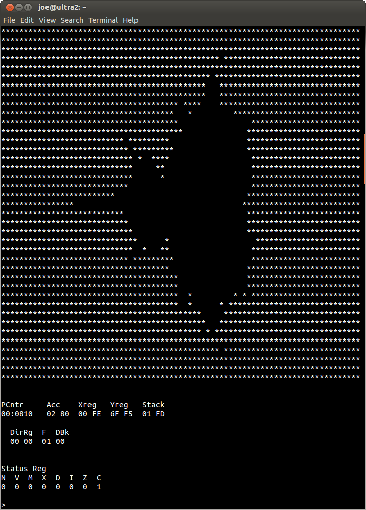

Made a 65816 target for the java_grinder byte code compiler. Mike posted a demo we used for testing stuff:
http://www.mikekohn.net/micro/apple_iigs_java.php
Right now there is a little bit of graphics API for the IIgs but not much else. However one may use inline asm like this:

Edit: forgot to share the Mandelbrot test I did on my shiny new W65C265SXB dev board:
PostPosted: Sat Sep 12, 2015 10:32 am
Posts: 578
That's pretty neat. I love the character Mandelbrot set drawing too.
