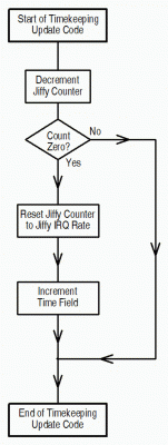

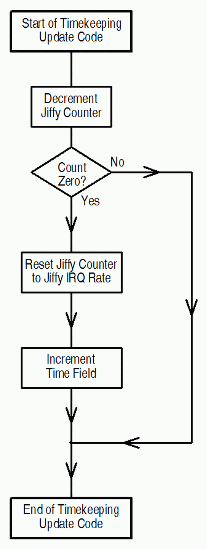

PostPosted: Mon Mar 30, 2015 1:41 am
Posts: 8507
Timekeeping is the product of a continuously-running "timepiece", which may be a wall clock, wristwatch, a counter in computer memory, etc. The timepiece keeps time without regard to whether or not someone or something is "watching" it. The process of referring to a timepiece or setting it to the correct time is not part of the timekeeping process. As will be seen, this distinction is important in the realm of computers, as the software used to keep time is not the same as that used to read or set the time, or to convert time between machine-readable and human-readable formats.
In this post, I will focus on the mechanics of timekeeping itself, and will discuss the process of reading or setting the time in a subsequent post. It should be noted that "time" in this sense refers to both the time-of-day (wall clock time or real time) and the calendar date, since the methods described in this topic manipulate a single variable that encapsulates both date and time-of-day.
As previously described, keeping time in UNIX and Linux is a process of incrementing an integer counter at one second intervals, which is an uncomplicated task. Code in an interrupt service routine (ISR) is executed at regular intervals in response to a periodic hardware interrupt request that is referred to as a "jiffy" IRQ. The source of the jiffy IRQ is the "time base," whose stability ultimately determines the degree of long-term timekeeping accuracy that will be attained.
Choosing a jiffy IRQ rate involves a tradeoff: a slower rate will generally produce coarser timekeeping resolution. However, the relatively low IRQ rate will improve perceived foreground process performance. On the other hand, a faster rate will produce finer timekeeping resolution, but at the expense of performance, since the microprocessor (MPU) will be processing more frequent interrupts.
It is recommended that the jiffy IRQ rate be a round number that can produce an even number of milliseconds between each increment of the time counter, such as 50 (20ms resolution), 100 (10ms resolution) or 250 (4ms resolution)—50 is the minimum rate that I recommend. The rate should be such that the corresponding number can fit into a single byte, an important consideration with the eight bit 65xx MPUs. In my POC unit, I use a 100 Hz jiffy IRQ, which is the most commonly used rate in UNIX systems (note that current Linux kernels use 250 Hz).
In the following discussion, UNIX time is maintained in a field defined as uxtime, which is a 48-bit integer. uxtime will be incremented at exactly one second intervals. A separate counter byte, referred to as jiffct—the "jiffy counter"—is used to keep track of how many jiffy IRQs have been serviced since the last update to uxtime.
jiffct is initially set to value hz at boot time, hz being the jiffy IRQ rate that has been defined for your system. Subsequently, jiffct is decremented with each jiffy IRQ. When jiffct reaches zero, it is reset to hz and uxtime is incremented. Of course, the ISR has to determine if the jiffy IRQ timer was responsible for the IRQ—if it wasn't, neither jiffct or uxtime would be touched.
The following flowchart illustrates a procedure that may be employed to keep time:
File comment: Timekeeping Update ISR Flowchart
As can be seen, it isn't complicated—in fact, the process is designed to be as simple and succinct as possible. Here's the code that would accomplish the above on a 65C02 or on a 65C816 running in emulation mode:

Continuing with programming, an interesting problem arises for foreground processes that need to get or set system time. uxtime never stops incrementing, even when a reference must be made to it. What this means is the possibility exists that an access to uxtime may produce erroneous results because the access was interrupted and uxtime was updated during the interrupt processing, resulting in a "carry" error. Hence there should be a way to prevent a carry error by deferring updates to uxtime when an access is required.
One method is to temporarily halt IRQ processing (SEI) and then immediately resume it after the copy has completed (CLI). Halting IRQ processing is simple and will minimally affect overall system performance. However, doing so may have an adverse effect on any interrupt-driven I/O processing, especially time-critical data reception from a UART that lacks a receiver FIFO (e.g., the MOS6551 or MC6850). Also, good operating system design generally frowns on the suppression of IRQ processing as part of a routine foreground API call, due to the potential for deadlock if something goes awry during the API call.
Another method is to using a semaphore to tell the ISR to defer the update of uxtime for one jiffy period—presumably, the foreground process accessing uxtime can finish in less than one jiffy period (if not, the operating system design needs rethinking, the hardware is in desperate need of an update—or both). Use of a semaphore doesn't disrupt any IRQ-driven activities and hence won't create any conditions that might provoke deadlock. However, some extra code is required in the ISR to manage the semaphore, which means there will be a small but inexorable amount of performance degradation.
Here are examples of how a semaphore, defined as semaphor, could be used to avoid uxtime read/write carry contretemps:
