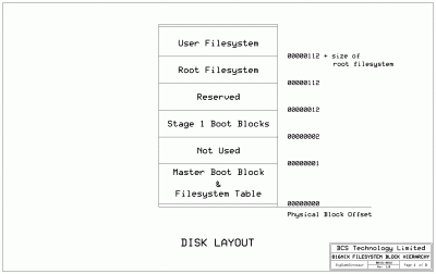

As I thought this thing through, I produced some simple drawings to help me visualize what I'm trying to accomplish. The first drawing is a layout of the entire disk with two filesystems, one of which would be the root filesystem for a UNIX-like environment.
File comment: Disk layout w/two filesystems.
This layout is similar to something you might find on a UNIX system disk where the S51K or Acer Fast Filesystem (AFS) is supported. The master boot block is one physical disk block and since a hard disk block is 512 bytes, has enough room for a filesystem table, minimal boot code and some administrative data that the BIOS would look at to determine if the disk is bootable. No partition table is used (or required), so the entire disk will be treated as a single device by whatever operating system controls it.
In my filesystem design, which I have temporarily dubbed 816NIX for lack of a better name, a maximum of four filesystems can be ensconced on a single disk, representing 256 GB of usable storage. Thirty-two bit addressing is used through out, which is why the maximum file size of 16 GB mentioned in the earlier post exists. Each filesystem has a slot in the filesystem table that includes the filesystem's name, its magic number, its size in physical blocks and where the filesystem can be found on the disk. In the case of a bootable disk, the first defined filesystem is the root filesystem and is where the system will go to find an operating system.
A fundamental characteristic of 816NIX is that all structures start on even logical block addresses (LBA). This has to do with the fact that the logical block size (1024 bytes) in the filesystem is comprised of two contiguous physical disk blocks, as previously described. This is apparent in the physical block offsets shown in the disk layout drawing. The reserved space from $00000012 to $00000112 will be used for several operating system features, one which involves setting up pipes. On a real UNIX system, pipes are either anonymous or FIFOs that exist as a file on disk. Anonymous pipes will be implemented within the reserved space, using raw disk access. I will also implement FIFOs, which are little more than some data blocks that have been a directory entry in filesystem.

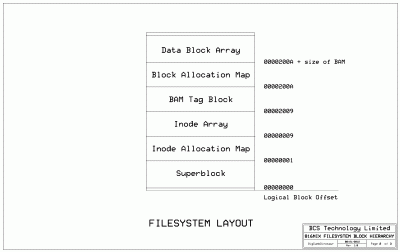

The next drawing is the layout of a typical filesystem (this drawing is a refined version of what I produced in the previous message).
File comment: 816NIX filesystem layout.
Note the reference to a "logical block offset" or LBO. Although disk blocks are addressed by LBA, the computations that figure out where files and other data are located within the filesystem are always zero-based. Once the LBO has been determined it is added to the starting LBA of the structure in question to get the LBA of the target disk block.

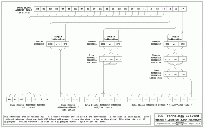

The last drawing is map of a maximum sized file.
File comment: Maximum sized file map.
Here, along with my use of a tagged bitmap to manage free filesystem data blocks, is one of the deviations from the S51K filesystem. In both S51K and AFS, the inode address table has 13 slots, of which 10 are pointers to direct address blocks. The implication of this feature is that if a file is no more than 10 KB in size, all accesses can be determined by calculating an offset into the inode table and using the LBA in the slot to access the proper data block—no indirect addressing is required. The result is a single disk access to get to the data, which is as fast as file access can get. The avoidance of indirect addressing is why UNIX or Linux FIFOs are limited to 10 KB—a FIFO should transit data with minimal delay, which would not be the case if indirect addressing was required.
The 10 KB threshold made sense back when machine resources were very limited (consider that the earliest UNIX system allocated 8 KB total to each user for code and data). We're not bogged down with such restrictions any more and I felt more efficiency could be gained by enlarging the inode address table. Over time, I've noted that a lot of file sizes fall into the 10 KB to 20 KB range, access to which would require indirect addressing with S51K or AFS. As can be seen in the drawing, the inode address table now has 24 slots, which means that files that are 21 KB or smaller don't have to use indirect addressing. A side-effect of this change is that the in-core size of an inode is much larger than before, 128 bytes instead of 64. As inodes have to be RAM-resident when a file is opened, there are RAM consumption implications—100 open files opened system-wide would require 12,800 bytes of RAM in which to hold inodes. Plus a table pointing to the in-core inodes has to be kept somewhere. You can see why the original S51K inode size of 64 bytes was important. If the operating system consumed a lot of RAM, there would be a real crimp on user space.
A fundamental piece of code that will be required to access files is something that can convert a zero-based byte offset (BOIF) into a file into an LBA and a byte offset in the block (BOIB). The first step is to compute an LBO and BOIB. The following pseudo-code handles that step:

The above will work for any BOIF from 0 to 21,503 inclusive, since the corresponding LBO will be in the range 0 to 20. The expression LBO*4,4 would magically index to an LBA in the BAT.
Once BOIF is 21,504 or greater, indirection is required. Here's a possible way to handle single indirection (refer to the file map to see which part of the file is being accessed):

Before continuing, I should mention that each indirect block is a table of LBAs that either point to another indirect block (applicable to double or triple indirection) or point to data blocks. In the indirection hierarchy, each indirection level has a master indirect block. In single indirection, the master block points to a maximum of 256 data blocks. The single indirection master block's LBA is gotten from slot $21 in the inode address table (BAT), as that slot is the first indirect slot. The computation of the variable MLBO points to slot 21 ($15), and is a simple case of subtracting out the direct address slots. The maximum BOF for single indirection is 283,647, which is the sum of the data stored in the 21 directly addressed data blocks (21,504 bytes) plus the data that can be stored in 256 single indirection data blocks (262,144 bytes).
Once BOIF goes over 283,647 double indirection becomes necessary. In double indirection, the master indirect block contains the LBAs of up to 256 fine indirect blocks, which in turn, contain the LBAs of the actual data blocks. As two levels of indirection are now involved, the code is a little more involved:

The above code is just an embellishment of the code used for single indirection. The maximum BOIF for double indirection is 67,392,511, which is the sum of the previous addressing plus the total number of data blocks that are pointed to by the fine indirect blocks, which amounts to 67,108,864 bytes.
Beyond a BOIF of 67,392,511, triple indirection is required. Here the master block points to a maximum of 256 coarse indirect blocks, which in turn, are able to point to a maximum of 65,536 fine indirect blocks, which in turn, can point to a maximum of 16,777,216 data blocks or 17,179,868,160 bytes. To that is added the bytes accounted for by the direct, single indirect and double indirect data blocks for an absolute maximum file size of 17,247,261,695 bytes, or 16 GB. Triple indirection would be accomplished as follows:

A total of four disk accesses will be required to reach the full extent of the file. As almost all operating systems use a block-random method of allocating storage to files, triple indirection can potentially be slow due to the required disk activity. While much less an issue with modern disks than with the stuff that existed back when I started working with UNIX, all this disk drive monkey-motion can reduce system throughput. An intelligent buffering system can help in that regard.
Now, I don't claim that the above algorithm is correct. It seems to be correct but perhaps someone else will spot an error of logic and/or omission.
Edit: 2012/08/28: I did discover an error in my algorithm, which upon looking back, was obvious but somehow overlooked. After I've tested the changes I'll write more about it.

Anyhow, to quote a formal definition of partitioning:
    Disk partitioning is the act of dividing a hard disk drive into multiple logical storage units referred to as partitions, to treat one physical disk drive as if it were multiple disks.
Note that no mention is made of filesystems. It just so happens that in MS-DOS, Windows and some others, only one filesystem can be defined per logical disk device. Particularly on x86 hardware, partitions (not filesystems) were a way to cope with the limited addressing capabilities of the early FAT filesystems as disk capacity evolved. Recall that the PC-XT was the first in the series to offer a hard drive, which was a whopping 20 MB—FAT12 couldn't address that much space, resulting in the development of FAT16 and beyond.
As for Linux, since it had its origins on the x86 architecture, where the concept of partitions already existed under MS-DOS, OS/2, Xenix, SCO UNIX and Windows, the decision to make a partition act as a single filesystem seemed inevitable and may well have been the result of an initial misunderstanding by Linus Torvalds of the difference between a filesystem and a partition. Linux could have just as easily been designed for use with a partition-less disk, as the BIOS itself knows nothing about partitions.
SCO UNIX and its derivatives treat partitions as partitions (that is, as virtual disks) and use what are called divisions within the active partition(s) to demarcate filesystem boundaries. Unless one is configuring a machine to support multiple operating systems, only one partition per physical disk is defined on SCO machines. That partition, of course, can have multiple filesystems.
The SCO division table is not stored in the boot block and has no relationship to the partition table. SCO's setup is much more flexible than Linux's (and more robust—boot block corruption doesn't affect the division table), as the latter is limited to four filesystems per disk, whereas SCO's division concept, which is controlled by an operating system command called divvy, allows up to eight filesystems per active partition. Also, it isn't overly difficult to move filesystem boundaries, unlike in Linux, where the partition table itself has to be manipulated.
I'm not sure I agree with your tactic of hard-coding disk layout in the filesystem, if that's what you're doing: even making up a convention of storing the offsets and sizes of the partitions (filesystems) and storing it in the boot block would be more flexible. Which is not to say it's essential, of course.
I think you've got that backwards. I didn't hard code the disk layout in the filesystem. The disk layout dictates where the major structures are located, that is, where the master boot block is, where stage 1 boot can be found and where to look for the filesystem table. All of these elements are of a fixed size of necessity, as they would be on any storage medium. In fact, part of my disk layout mimics that of the SCO UNIX layout, which as I noted, is very robust—much more so than the archetypal PC layout under DOS or Windows.
The disk layout indirectly dictates where the first filesystem will start. The other three filesystems, if defined, are located relative to the end of the first filesystem, which can be an arbitrary size up to the full extent of the disk if desired. Therefore, nothing about filesystem locations is hard coded. It just so happens that the first filesystem starts at the same point on any disk connected to the computer because the "invisible" static structures are defined in size and location, which would be the case no matter the operating system (take a good look at what is in physical block zero of the boot drive in any PC to see that this is the case). It is certainly possible to define the first filesystem to start elsewhere on the disk, although doing so would mostly waste space.
Incidentally, I decided on the four filesystems per disk limit only to avoid using up too much space in the boot block. Also, I was being realistic about RAM space consumption. Each mounted filesystem would have to have a copy of its superblock in core at all times, which amounts to 1 KB RAM space per filesystem. It's patent that having a lot of mounted filesystems would quickly eat up a lot of RAM.
Each filesystem's internal relationships are, of necessity, hard coded relative to the start of the filesystem (i.e., the origin of the superblock), otherwise the operating system wouldn't know where to look for the key filesystem structures. Again, this mimics current practice. The physical disk blocks that make up the various filesystem structures (inodes, BAM, etc.) are determined at the time the filesystem is created, and that is accomplished by computing offsets to the filesystem's origin. The filesystem table itself is stored early in the boot block right after a jump vector to the master boot code and a magic number, simply as a matter of convenience—it could have been stored in physical block $00000001 instead of physical block $00000000. The filesystem table must also, by necessity, have a fixed location in order for the first stage boot loader to be able to find it and subsequently find the root filesystem to continue the operating system load.
The draft version of the filesystem table is as follows:
  FILESYSTEM TABLE LAYOUT   Offset in Table
|   4th filesystem slot   |
+—————————————————————————+ $38
|   3rd filesystem slot   |
+—————————————————————————+ $26
|   2nd filesystem slot   |
+—————————————————————————+ $14
|   1st filesystem slot   |
+—————————————————————————+ $02
|      1st open slot      |
+—————————————————————————+ $01
|   active entries (0-4)  |
+=========================+ $00
Again, the offsets are relative—relocating the table to a different part of the disk won't affect anything.
A filesystem table slot appears as follows:
  FILESYSTEM TABLE SLOT LAYOUT    Offset in Slot
|        superblock LBA         |
+———————————————————————————————+ $0E
|             name              |
+———————————————————————————————+ $06
|         magic number          |
+———————————————————————————————+ $02
|           not used            |
+———————————————————————————————+ $01
|             flag              |
+===============================+ $00
The (bit-wise) flag indicates if the filesystem is active and also indicates if the filesystem is to be mounted read-only or read/write.
All of the above mimics current practice, so I'm not inventing anything here, just adapting.

In the previous post I rambled a bit about a filesystem that could be adaptable to my POC unit's mass storage facilities...A fundamental piece of code that will be required to access files is something that can convert a zero-based byte offset (BOIF) into a file into an LBA and a byte offset in the block (BOIB)...
I decided to sleep on this for a while before trying to actually implement it. In the process, I wrote a program to run on POC that would generate the structure of a maximum-sized file (4GB) so I could test my theories. At 4GB, all levels of indirection are used, resulting in the most complex structure that would be produced in a real file. Generation resulted in the writing of over 8 million disk blocks, so it took a while for this program to finish. I used a fake inode defined in RAM rather than a real one on the disk, since anything involving the manipulation of a inode would be working on a core copy.
Once that file structure had been produced I started to see relationships that I wasn't seeing on paper, causing me to revise my thinking on how to convert a byte offset in a file (BOIF) into the values needed to access the file, that is, the logical block address (LBA) and the byte offset in that block (BOIB). As it turns out, it isn't very complicated.
In the following pseudo-code, all values are unsigned and division is integer division, that is, Q=floor(N/D) in C.
First, here are some needed atomic constants:
    S_WORD = 2                    ;bytes in a word (16 bits)
    S_DWORD = 4                   ;bytes in a double word (32 bits)
    S_LDBLK = 1024                ;bytes in a logical disk block
    N_DIRLBA = 21                 ;number of direct address blocks
The first step is to compute a zero-based logical block offset (LBO) into the file, which will then lead to the computation of BOIB.
    LBO = BOIF / LBS              ;compute logical block offset
    BOIB = BOIF - LBO * S_LDBLK   ;compute byte offset in data block
This is the same as the start of the algorithm I mentioned in a post above.
As previously described, only a small number of the total data blocks assigned to a file are directly addressable from the inode, the N_DIRLBA value. The balance of the file has to be accessed via indirect addressing, the degree of indirection being determined by how far into the file the desired access point is located. So the next step is to determine if indirection is required and if so, the degree of indirection that is required:
    INDIR = 0                     ;degree of indirection
    WHILE LBO => INDIRTAB(INDIR)  ;determine degree of indirection
       INDIR = INDIR + 1
    WEND
    LBO = LBO - MLBOTAB(INDIR)    ;adjust logical block offset as needed
    ;data tables...
    INDIRTAB  N_DIRLBA            ;single indirection
              N_DIRLBA + 256      ;double indirection
              N_DIRLBA + 256 + 65536 ;triple indirection
              4294967295          ;sentinel value
    MLBOTAB   0                   ;no indirection
              N_DIRLBA + 65536    ;triple indirection
Upon completion of the above, LBO is the logical block offset relative to the degree of indirection. If LBO < N_DIRLBA then LBO will be unchanged, INDIR = 0 and direct addressing is used. In such a case, no other work is required other than to retrieve the data block LBA corresponding to LBO from the inode block address table (IBAT):
    LBA = IBAT(LBO*S_DWORD,S_DWORD)
where the expression LBO*S_DWORD,S_DWORD would magically index to an entry in IBAT (if only it were that simple in assembly language).
If INDIR > 0 then indirection is required, which involves accessing one or more indirect address blocks in order to find the LBA of the block in which the data is located. In this case, INDIR tells us how many indirect blocks will have to be read. Each indirect block is a table of LBAs, 256 maximum per block, that either point to another indirect block (applicable to double or triple indirection) or point to data blocks. Each indirection level has a master indirect block, whose LBA is stored in IBAT and can be derived as follows:
    MLBA = IBAT((N_DIRLBA+INDIR-1)*S_DWORD,S_DWORD)
where (N_DIRLBA+INDIR-1)*S_DWORD,S_DWORD indexes into the inode block address table. With the master block's LBA "in hand," the following pseudo-code would load the block:
    getblk(MLBA,BUF)              ;load block into BUF
Once the master block has been loaded, the following relationships determine how to proceed:
  • Single indirection: master block points to data blocks.
  • Double indirection: master block points to one or more fine blocks. Fine blocks point to one or more data blocks.
  • Triple indirection: master block points to one or more coarse blocks. Coarse blocks point to one or more fine blocks. Fine blocks point to one or more data blocks.
Now, let's suppose LBO = 1234567, a random value I've pulled from my hat. That value of LBO means that INDIR = 3. As it so happens, the largest possible value of LBO after processing by the above loop can never exceed 4,194,303 because the largest possible file size in a 32 bit filesystem is (surprise!) $FFFFFFFF or 4,294,967,295 bytes. Divide that by the logical block size of 1024 bytes and you get 4,194,303 or $3FFFFF blocks. Hence LBO can be represented by a three byte binary value. In this case, LBO = 1234567 is $12D687,
Now, consider the master ? coarse ? fine progression. We've already noted that any indirect block can store up to 256 LBAs. Since the fine blocks are the lowest level of the indirection chain and the master block is the highest, we can view the $12 byte of $12D687 as the index into the master block, $D6 of $12D687 as the index into the coarse block, and $87 of $12D687 as the index into the fine block, since working our way up the hierarchy from fine to master involves multiplying by 256 for each indirection level.
So, with the master block loaded into BUF, we can get the coarse block corresponding to LBO with:
    getblk(BUF($12*S_DWORD,S_DWORD),BUF)
and the fine block corresponding to $12D687 with:
    getblk(BUF($D6*S_DWORD,S_DWORD),BUF)
Finally, the data block itself can be gotten with:
    getblk(BUF($87*S_DWORD,S_DWORD),BUF)
If double indirection is involved, the process is reduced to two steps, as the most significant byte of LBO will be zero. If single indirection is involved, the process is reduced to one step, as the middle and most significant bytes of LBO will zero and can be ignored.
All of this is surprisingly easy to program in assembly language when using the W65C816S, as its ability to do 16 bit loads, stores, shifts and arithmetic operations greatly reduces the amount of code required, as well as the time required to perform the operation. Consider the step where LBO is adjusted:
LBO is a 32 bit value stored in the 6502's characteristic little-endian format, and if one were programming the 6502 or 65C02, the code to adjust LBO would be as follows:
         ldx #0                ;number index
         ldy #s_dword          ;bytes to process
