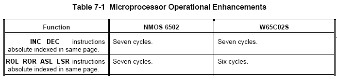

dclxvi wrote:
Do all 65C02s behave like this?
In addition to the GTE 65C02 mentioned in the lead post, at least two other C02's feature this odd quirk. Today I confirmed its presence on a recently purchased WDC 'C02 (a W65C02S6TPG-14) and on an old Rockwell (a R65C02P4). I'll bet all C02's have it.
The matter is unimportant except where exact cycle counts are required. And it reminds us -- as if a reminder were needed -- that documentation can't be trusted!
Recap: indexed addressing raises the possibility of a page crossing, which means an extra cycle may be required prior to the memory access. But for some indexed Read-Modify-Write instructions an NMOS chip will always include an extra cycle, even when no page crossing occurs. Specifically, Read-Modify-Write instructions using Absolute,X address mode -- opcodes $1E, $3E, $5E, $7E, $DE and $FE -- always include the extra cycle, which is unnecessary if there's been no page crossing.
Table 7-1 excerpt (original).gif (6.04 KiB) Viewed 6185 times

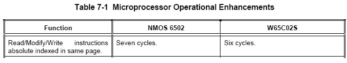

Table 7-1 of the WDC datasheet (excerpt above) claims this issue has been corrected for the CMOS chip. But in fact that's only true regarding ROL ROR ASL and LSR. The fix does not apply to INC and DEC.
Table 7-1 should read as shown below. (I edited the image to create a corrected version.)
Table 7-1 excerpt (corrected).gif (8.17 KiB) Viewed 6185 times
As noted, ROL ROR ASL and LSR are fixed. Without a page crossing there'll be no extra cycle. With a page crossing there will be an extra cycle, during which PC presumably (I didn't check) appears on the address bus -- thus needlessly but harmlessly re-fetching the third byte of the instruction.
INC and DEC aren't fixed. Without a page crossing the extra cycle needlessly appears anyway, and the address is the same as that during the following cycle when the RMW actually commences. IOW the same address is accessed four times in a row -- three reads then a write. With a page crossing there will be an extra cycle, during which PC appears on the address bus; then the RMW commences.
The Rockwell and WDC chips behave identically. As for the doc, Rockwell neglects to mention the quirk and the incomplete fix. OTOH the Rockwell doc lists all RMW instructions using Abs,X as seven cycles, making it inaccurate in a different way than the WDC doc.
ps: -- thanks to dclxvi, who first brought this to our attention.
